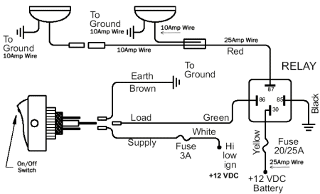

So tell me have you thought about just using a relay and wiring it from your switch to a relay and then to the lights? Therefore not using the BCM for the ground? Wiring it like such.
https://images.2carpros.com/forum/automotive_pictures/249564_relaydiagram_small_1.gif
Sep 1, 2009 at 3:06 AM
BEASTFROMTHEEAST
  • 9 POSTS
I could doit as I have drawn it out here as well and use the existing foglight switch(ground reference) however they would be on until the lights went out or the truck was shut off. In order to shut them off I would need the momentary push button drawn in here. The problem is drilling holes in the dash and cutting wires at the BCM to do this. Then there is no going back. I guess I just am to thick to understand why with thousands of these trucks running around with the foglight option working from the factory with then same part number BCM as mine why nobody on the planet knows how to program it. They had to program it on the factory option when they came stock. I find it hard to believe that if a factory equiped truck with foglights cooks a BCM the dealer says " by the way you foglights will not work any more cause we can't program them" I mean you must admit I have a point there, right? Thanks-Bruce

I don't trust that I can find anyoneto do it for me, remember every time it cost money for a new BCM.
I have drawn up a set of 4 relays that should work off the ground reference and allow me to turn on or off with a pulse from the orignal switch. Having it hooked to the ashtray light will supply 12 volts only when lights are active. A pulse from the switch and output tothe foglight relay should makeit go.I ordered some small relays and a small enclosure to build it all with. That my next move-Bruce

Hey didn't think of doing it that way. That will make it work just as you want. Don't blame you on the lack of trust.
