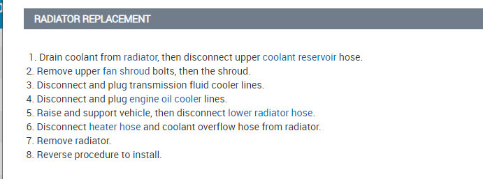

How can i tell if my oil cooler is not working right and letting water get into my oil I have high hopes that is what it is and not an intake gaskit or head. If anyone can help thanks in advance

Unfortunately the oil cooler is part of the radiator so it could be the issue.
Here are a couple guides that will help with this:
https://www.2carpros.com/articles/coolantantifreeze-in-the-engine-oil
Once we know the results of this we can better determine is there is another issue.
However, if the gasket is okay then the cooler is the issue but you can pressure test the cooling system to confirm this.
https://www.2carpros.com/articles/radiator-pressure-test
Below is the process to replace the cooler but it is part of the radiator so you need to replace the radiator.
Let us know if you have other questions. Thanks
