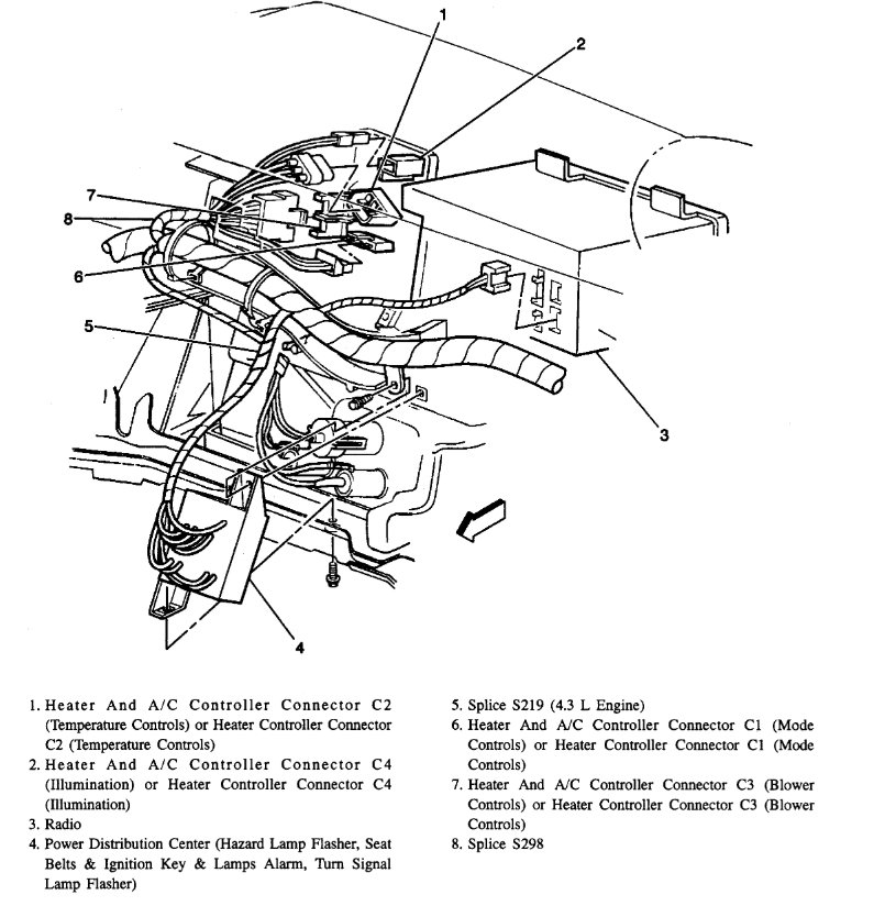

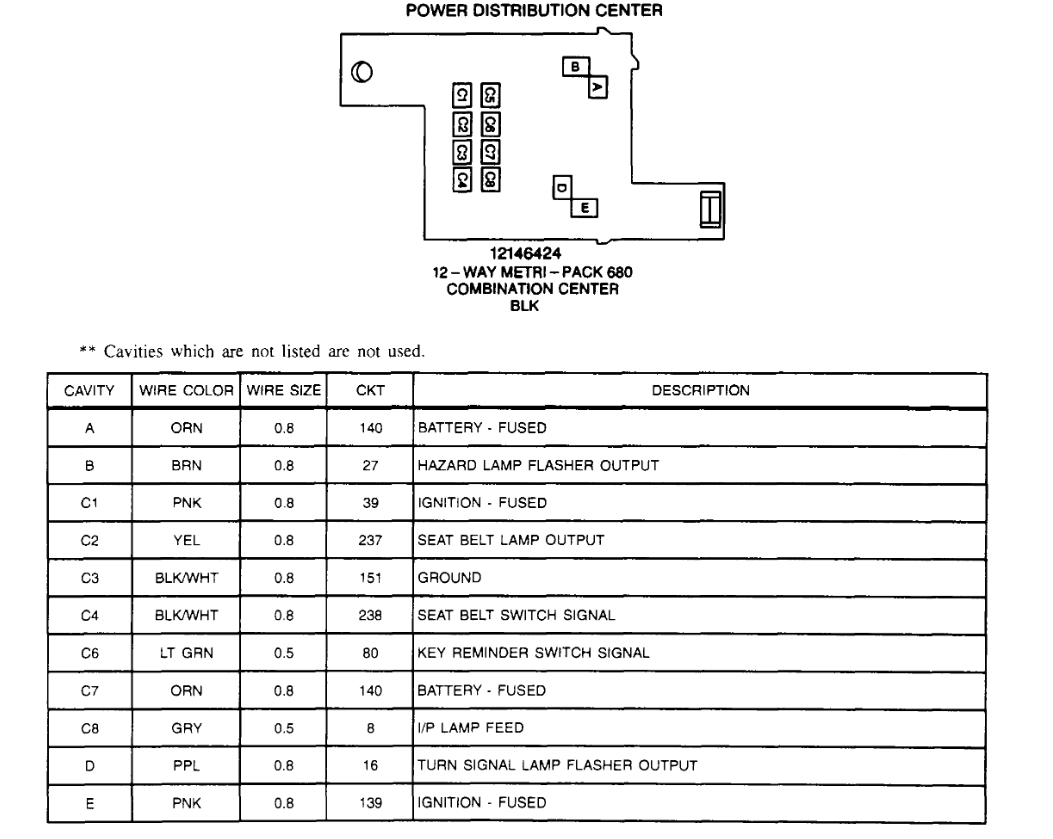

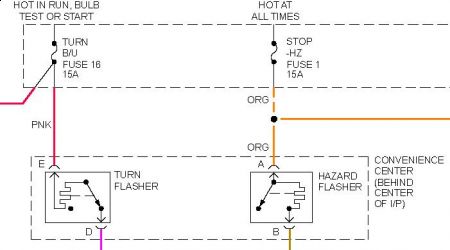

2CARPRO JACK
  • 11,533 POSTS
The flasher for the turn signals is in the power distribution center below the left side of the dash, round silver thing with 2 prongs on the plug. Check out the diagrams (Below). Please let us know if you need anything else to get the problem fixed.

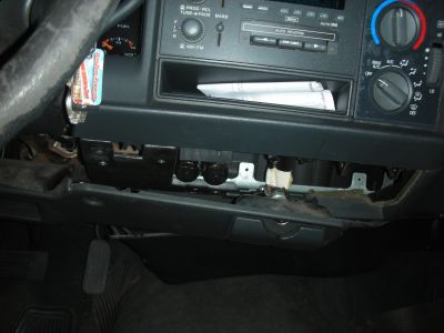

WILLIAM CHAUVIN
  • 6 POSTS
Thanks for the info. --but --the flasher is not on left side of dash.It is in center os dash board under radio next to cigarette lighter --behind panel.

WILLIAM CHAUVIN
  • 6 POSTS
Yes Ken the signals are working fine now. After I droped the bottom panal I replaced both blinkers. The old ones were aluminum and replaced with new dark plastic cased ones.(Auto zone) as shown in photo.

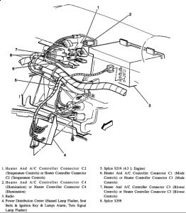

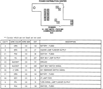

DAVE H
  • 13,384 POSTS
Hello .. thanks for the donation .. much appreciated
Hazard/Turn Signal Flasher (Analog Cluster)On convenience center.
Hazard/Turn Signal Flasher (Digital Cluster)On fuse block.
https://www.2carpros.com/forum/automotive_pictures/266999_s10_1.jpg
Hope this helps

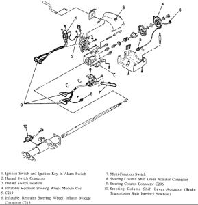

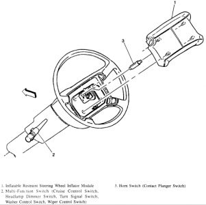

  • 75,992 POSTS
TURN SIGNAL LAMPS FLASHER
I/P Wiring (Center)
https://www.2carpros.com/forum/automotive_pictures/12900_tsf1_2.jpg
Power Distribution Center
https://www.2carpros.com/forum/automotive_pictures/12900_tsf2_2.jpg
The Turn Signal Lamps Flasher is located in the Power Distribution Center. The Power Distribution Center is located in the Instrument Panel below and in front of the Radio.
Turn Signal Switch
Inflatable Restraint Steering Wheel Inflator Module
https://www.2carpros.com/forum/automotive_pictures/12900_tssc1_1.jpg
Steering Column Assembly
https://www.2carpros.com/forum/automotive_pictures/12900_tssc2_1.jpg
WARNING: Refer to Air Bags and Seat Belts/ Air Bags (Supplemental Restraint Systems)/ Service and Repair/ Air Bag System Disarming & Arming.
1.Remove ignition lock.
2.Remove shift lever clevis, then the lever from vehicle.
3.Remove wire harness straps, then disconnect steering column bulkhead connector from vehicle wire harness.
4.Disconnect turn signal switch gray and black connectors from column bulkhead connector.
5.Remove pan head tapping screws, then the turn signal switch assembly from column.
6.Reverse procedure to install. Torque pan head tapping screws to 53 inch lbs.
