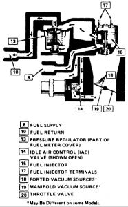

My '89 chevy S10 is having trouble starting in the morning, and after sitting for a extended period of time. I have replaced the Fuel Pump and Fuel Filter. I was advised by a friend that the problem was more than likely the Fuel Pressure Regulator Diaphragm. I have bought a new one but am not sure where it is located on my truck.
Oct 12, 2010 at 12:03 AM
JDL
  • 16,098 POSTS
Pressure regulator is number 6 and 7 in the picture. For model 700 TBI. Also, when you replaced the fuel pump if there was a pulse dampener between the pump and the tank unit, it should be removed and replaced with a piece of fuel injection hose.When the dampeners go bad they will cause pressure issues

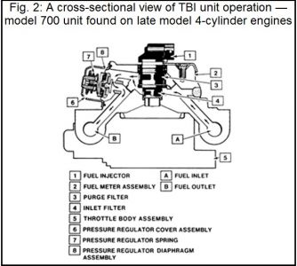

Repair manual say's that when replacing the fuel pressure regulator, that fuel meter cover and regulator should be changed at the same time due to a strong spring that is under pressure-not to remove the 4 screws that hold it down. It looks like a model 220 throttle body. Store just sells fuel pressure regulator. The question that I have is if it is that big of a deal (hard) to put the regulator in? I also heard that you have to change the oil because a lot of gas flows into the crank case from the broken diaphragm. It would be nice if the manuals would give that advice.All help is appreciated!
Apr 11, 2019 at 11:05 AM (Merged)
  • 75,992 POSTS
What you've been hearing is all true
https://images.2carpros.com/forum/automotive_pictures/12900_fp_56.jpg
The pressure regulator is a diaphragm-operated relief valve with system operating pressure on one side and and atmospheric pressure on the other side. The function of the regulator is to maintain a constant pressure to the injectors at all times, by controlling the flow in the return line by means of a calibrated bypass. NOTE: The pressure regulator on this unit is serviced as part of the fuel meter cover and should not be disassembled.
