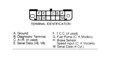

i have a 2.5 4 cylinder that i can not get to run right i cant get the timing right i put #1 top dead center and tried to time it but the only way it will run half way normal is to put timing mark on 4 but it still back fires i changed all sensors and distributer so now i need to know how to run diagnostic test on it myself to see what it tells me where can i find that information out and what the codes mean, i just know im about ready to take this truck to a wrecking yard please help before it comes down to that
Jul 22, 2010 at 12:18 PM
JDL
  • 16,098 POSTS
In the left column for this forum there is a link for code definitions, or just post the code. You turn the key to on, no crank, no start. Place a jumper wire between terminals A & B at the datalink connector. The check engine lite starts flashing, you count the flashes to get the codes. Your looking for two digit codes. You need to check compression, without good compression it may never run right? Minimum spec is about a 100 psi, difference between cylinders no more than 30 psi.

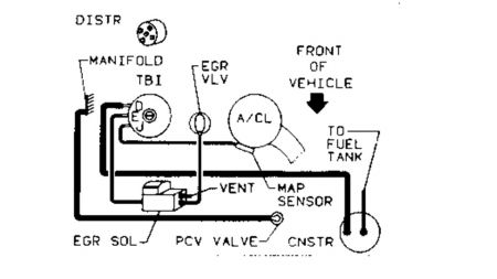

i checked compression its good got all new sensors the only way i get it to run good but it still backfires is to leave one of the vacuum ports on the side of throttle body disconnected but if i plug it in the truck dies so i have to let it suck air or it wont stay running so im confused it shouldnt run good at all with it disconnected.
Jul 23, 2010 at 3:11 PM
JDL
  • 16,098 POSTS
Which vacuum line?
