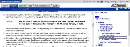

When timing engine is there a defuser or wire to disconnect to stop timing advance?

You need to disconnect the EST wire tan and black wire-see below info

V6 IGNITION TIMING 1. Set parking brake, block drive wheels and place transmission in Neutral or Park. Warm engine to normal operating temperature. Turn A/C off (if equipped). Ensure Malfunction Indicator Light (MIL) is off. 2. Disconnect Tan/Black Electronic Spark Timing (EST) by-pass connector wire. DO NOT disconnect 4-wire connector at distributor. 3. On models where engine computer is located underhood, on right fenderwell, by-pass connector which is a single Tan/Black wire, breaks out of wiring harness near engine computer harness connectors. 4. On models where engine computer is located in passenger compartment under right side of instrument panel, by-pass connector which is a single Tan/Black wire and breaks out of wiring harness where heater box and carpet meet on passenger side floor. Pull back carpet to expose single Tan/Black wire and connector on outside of control module harness. 5. On all models, connect timing light to No. 1 spark plug wire. Check timing and adjust if necessary. See V6 IGNITION TIMING table. Reconnect EST by-pass connector, and clear ECM trouble code. NOTE: The location of the EST by-pass connector has been updated per General Motors Service Manual Update number 41-65-41, dated January 4, 1995.
Timing is 0 degrees at idle, both auto and manual trans. Soory Razz! But this IS clearer!

It is well hidden tan wire with black stripe taped to harness coming out of passenger side kick panel.has took me 14 years to find

You could also jumper A TO B terminal at the 16 pin data link connector under drivers dash it will disable timing advance also. Hope this was helpful.
