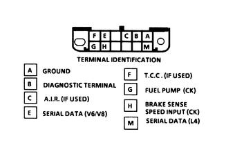

If your computer controlled, there should be a datalink connector, lower edge of dash, close to steering column. You place a jumper wire between terminals A & B at the datalink connector. then, turn the key just till the dash lites come on, no further. The mil starts flashing, you count the flashes to get the codes. Your looking for two digit codes. The picture below is only to reference A & b TERMINAL location. I sure thought you had a datalink connector? I've been wrong before.
https://www.2carpros.com/forum/automotive_pictures/170934_obd_1_datalink_connector_4.jpg
