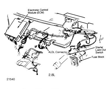

Truck was running just stopped. Thought it was a fuel problem. Had the module under the distributor cap check at Auto Zone. It was fine. Bought a fuel pump relay. Replaced the fuel pump in gas tank. Fuse for ECM keeps blowing. Replaced fuse. Blows. ? Does this truck have a computer? If it does where is it located? Could it be the electronic spark control? Do you have the electrical schematic for this year truck?

The ECM/PCM/ECU it the same thing is at under right side of dash see below You need to find the short that's causing the ECM fuse to blow-the wire you looking for is the orange wire from the fuse to the computer 12v Batt.
https://images.2carpros.com/forum/automotive_pictures/12900_ecm_14.jpg
