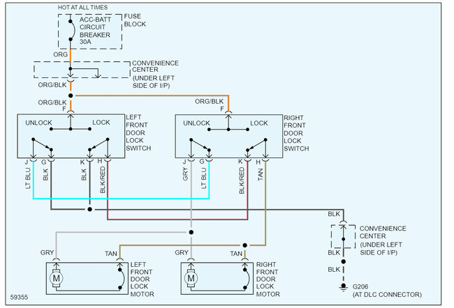

A few months ago the power locks stopped working in my truck. What is strange is that the power windows still work fine. I have changed all the fuses without any success. Also, the passenger side button will unlock both doors, but will not lock them. The driver side will not do anything. Any suggestions?

hey i would start with switchs for both sides there priced decent and could just be that simple. If that dosent work you basically need manuals from the dealer and a mutimeter,testlight,and jumper wire to diagnose further.I just repaired my locks on a 94 camaro.good luck to you.

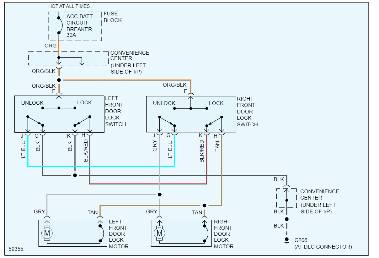

If the passengers side works it means the switch on the drivers door has gone bad but to be sure here is a guide to help you check for power and I have included the door lock wiring diagrams so you can see how the system works and which wires to test. Also check the ground under the left side of the instrument cluster.
Check out the images below. Please let us know what happens.
