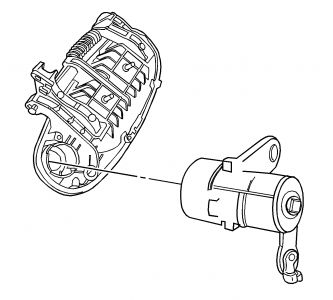

I unlocked my car door this morning to go to work and when I went to lock it the lock has moved in and I cannot get to it with the key. What could have caused this?
Aug 8, 2007 at 8:41 AM
DENNYP
  • 1,824 POSTS
the retaining clip might have come off the lock cylinder.
https://images.2carpros.com/forum/automotive_pictures/102900_1248288_1.jpg
