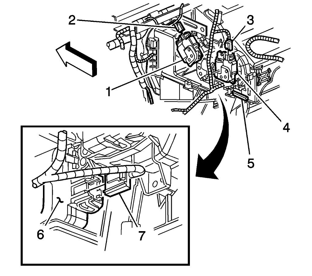

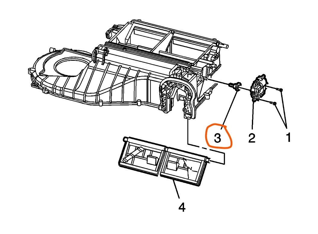

There can be two actuators if it has the dual zone system. However, it and the single zone both use the same actuators. The left actuator for the single zone system is at the bottom of the HVAC case just above the footwell. You remove the bolster under the drivers dash and the actuator is the lowest one on the case. Has 2 screws that hold it to the case. There is a small shaft that only goes in one way. Be sure it is place.

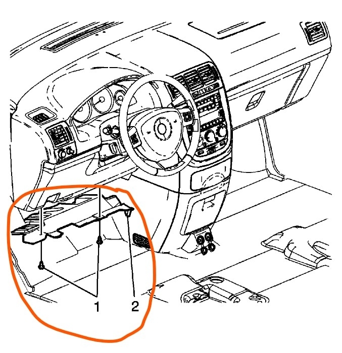

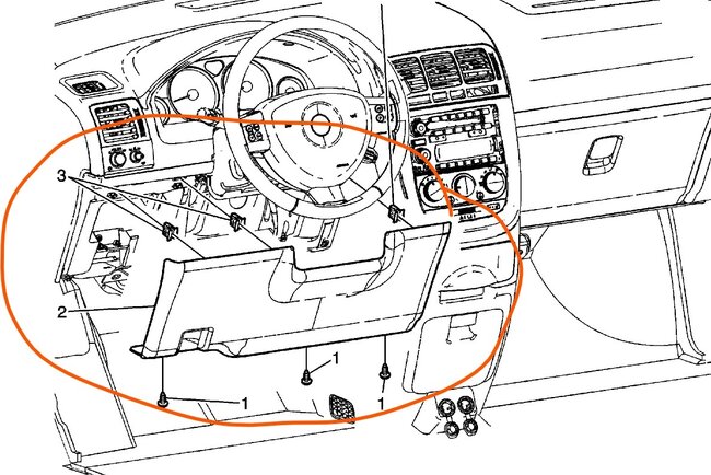

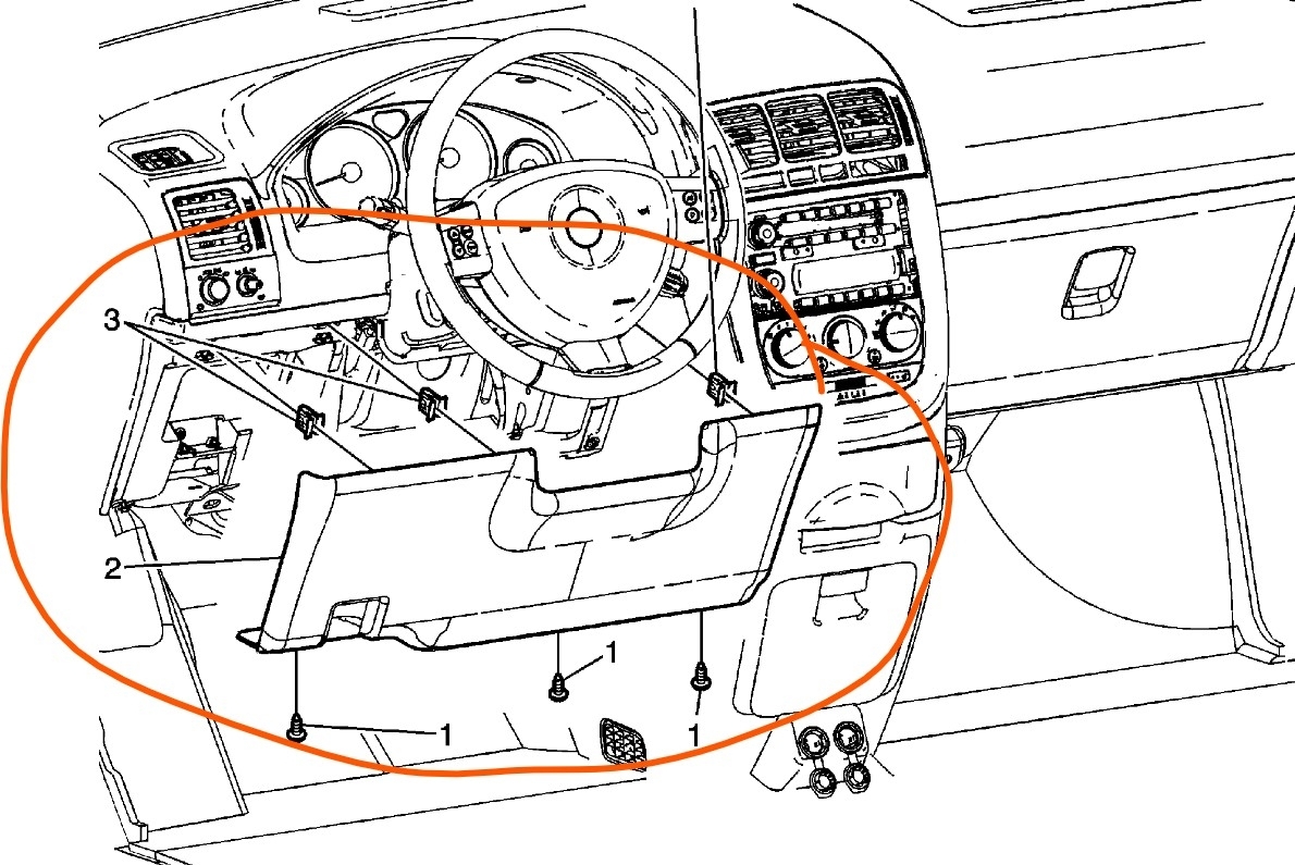

Shouldn't take that much. These are the two panels that have to come off to get to the actuators.
Mar 18, 2025 at 11:57 AM
