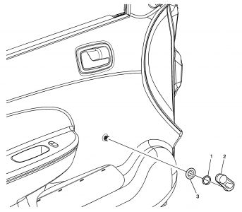

I can't figure out how to get the window crank off my 06 Chevy Cobalt. Need to get at the door handle stuff and can't. Anyone got an idea?

Door Window Regulator Handle Replacement Callout Component Name Fastener Tightening Specifications: Refer to Fastener Tightening Specifications . 1 Retainer Clip 2 Window Regulator Crank Tip Use the J 9886-01 Door Handle Clip Remover to remove the crank handle. 3 Window Regulator Washer
https://images.2carpros.com/forum/automotive_pictures/102900_1538059_1.jpg
