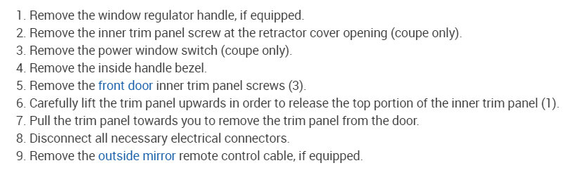

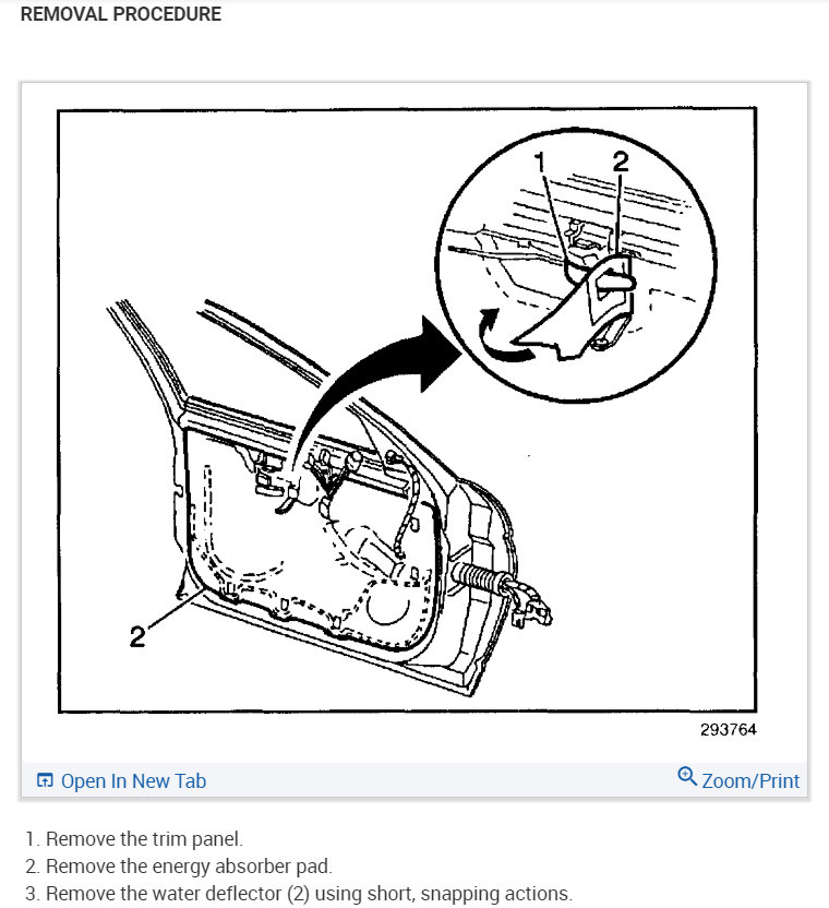

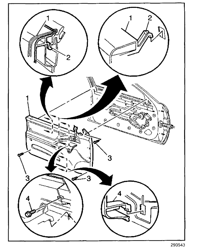

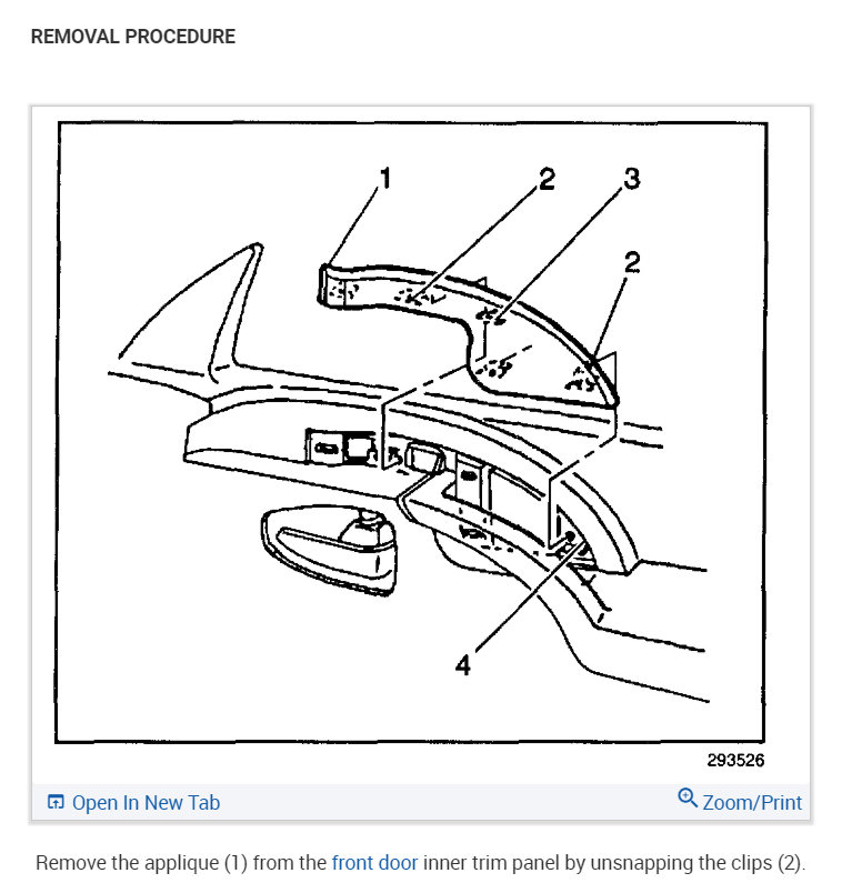

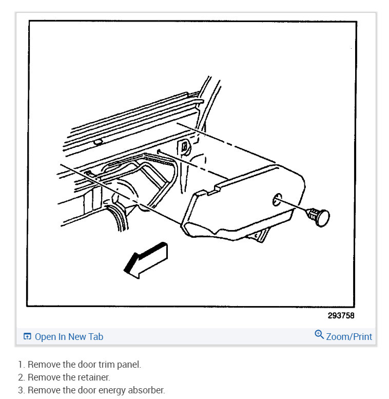

How do I remove the interior door panel on a 1999 monte carlo? I have removed the 6 screws around the panel, the one inside the latch and removed the mirror control on top but it still feels like it is connected to something in the center of the door.
Mar 10, 2007 at 4:31 AM
CHEVY22
  • 1,375 POSTS
This guide will walk you through the steps with instructions and diagrams below to show you how on your car.
https://www.2carpros.com/articles/door-panel-removal
