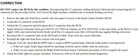

KWABBOTT
I was having the same exact problems. Brake lights staying on or flashing. Also, my cruise would not work and it was sometime hard to get car out of park. I was at my wits end and then found that there was a service bulletin for this problem. Apparently it all relates back to the C2 connector which is located in the center consol on the passenger side. The bulletin says to unlatch and disconnect the c2 connecter then connect and relatch...then repeat a few times. It also said to spread dielectric lubricant on the connecter. I did not do this last step, but it has been two weeks and my brake lights no longer flash, my cruise works and it is now very easy to shift out of park. I hope this helps. I found the service bulletin on another forum. Apparently 2005-07 and 08 malibus experience this problem as does a pontiac car as well. Hope this helps.
Jan 6, 2020 at 4:24 AM (Merged)
