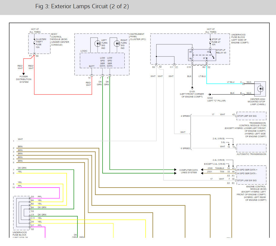

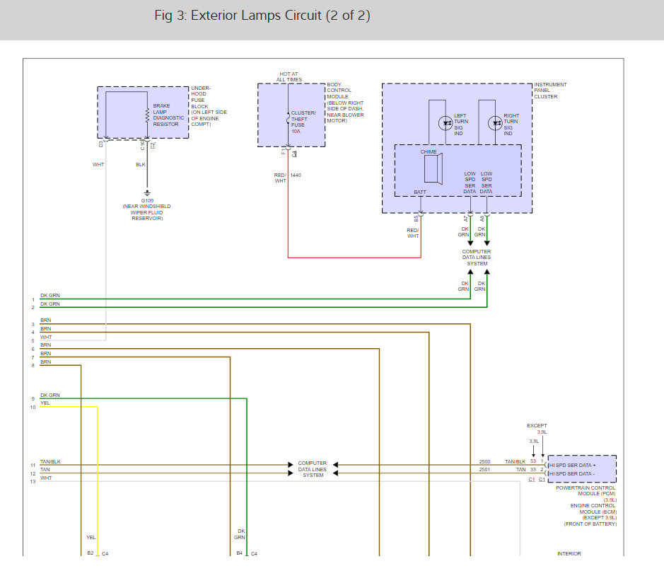

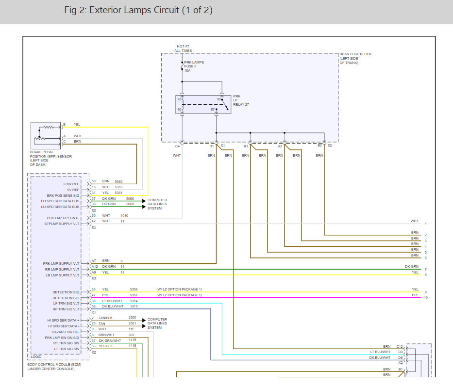

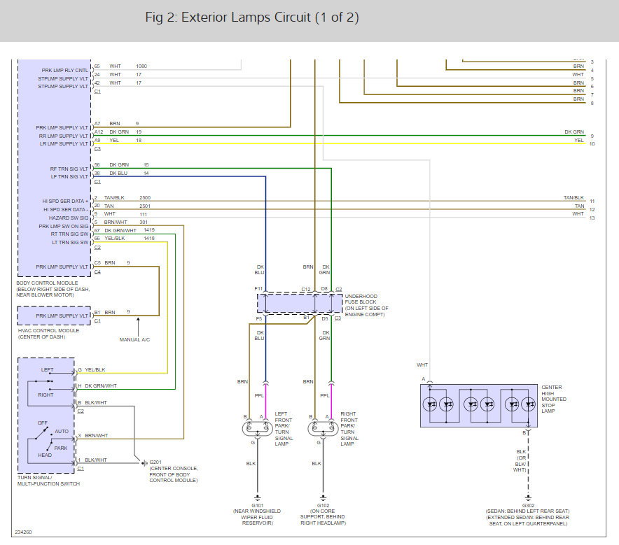

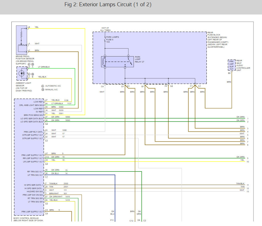

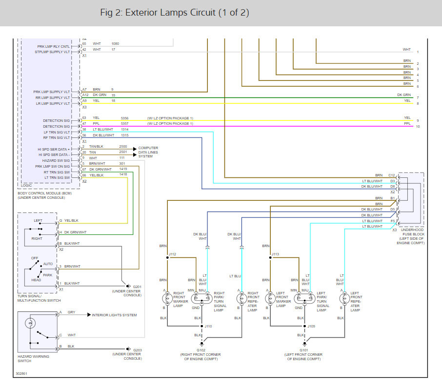

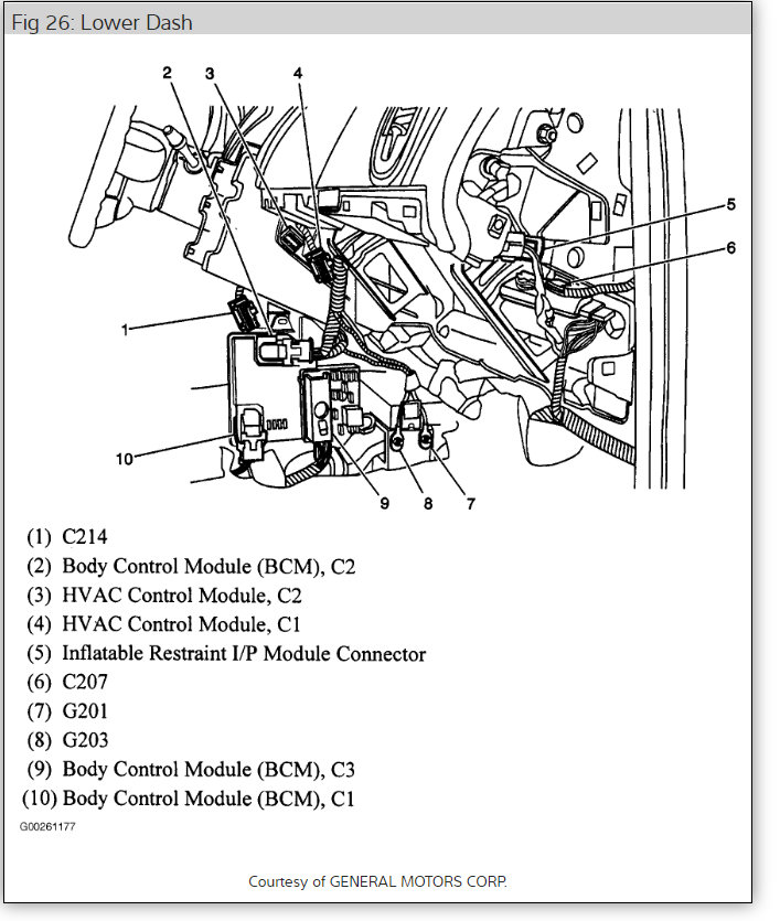

brake lights stay on until you step on brake pedal
Apr 27, 2010 at 7:35 AM
BMRFIXIT
  • 19,053 POSTS

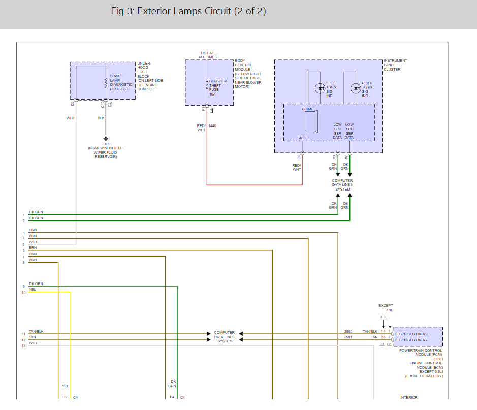

This sounds like a problem witht eh BCM but to be sure here is the brake light wiring diagrams so you can see how the system works. Check out the diagrams (Below). Please let us know what happens.
Jan 3, 2019 at 1:53 AM

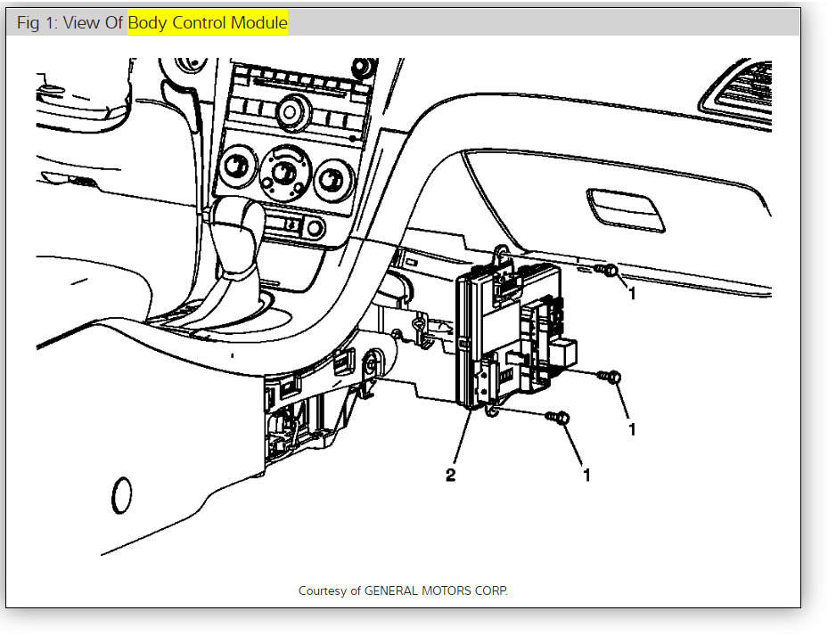

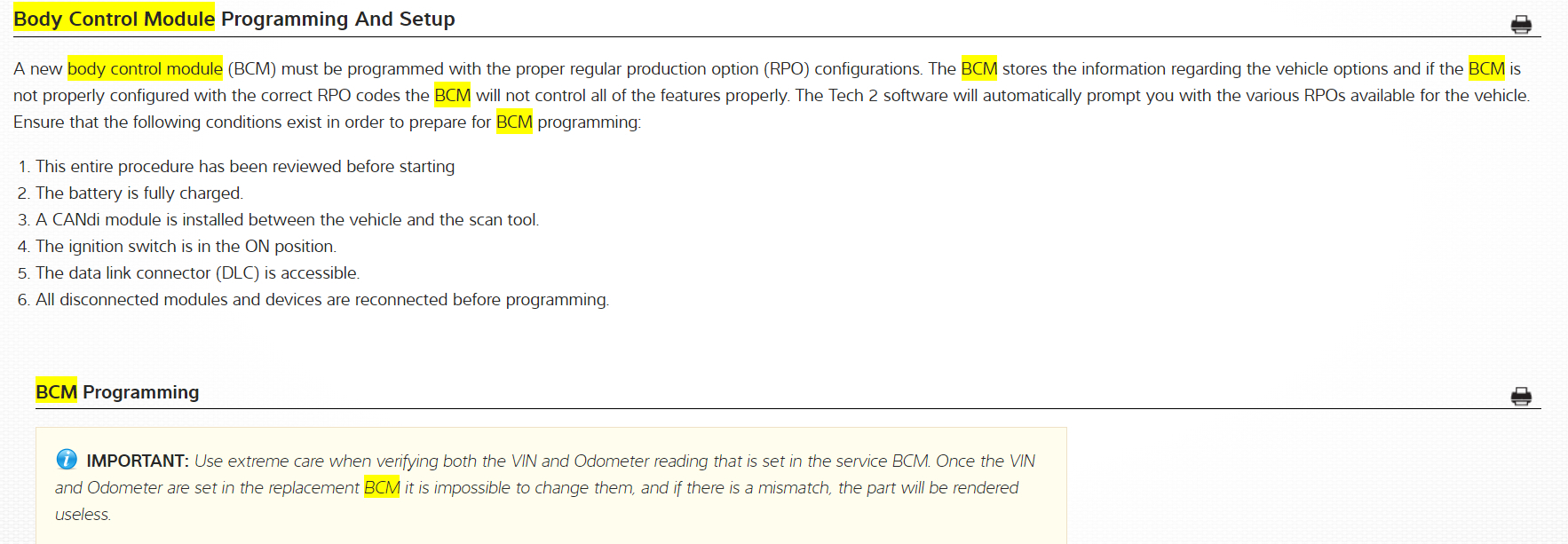

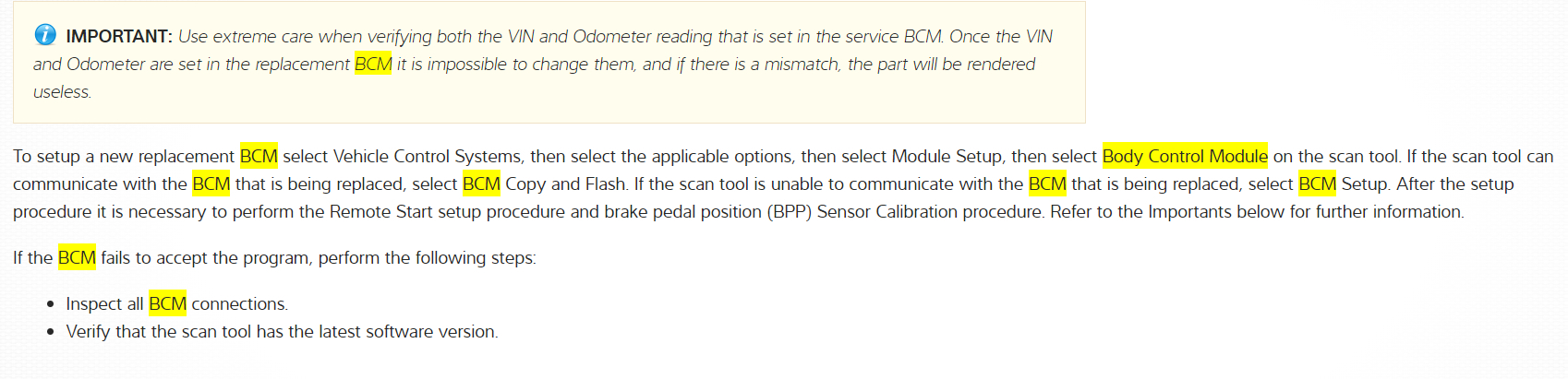

Here is how you replace the BCM in the diagrams below.

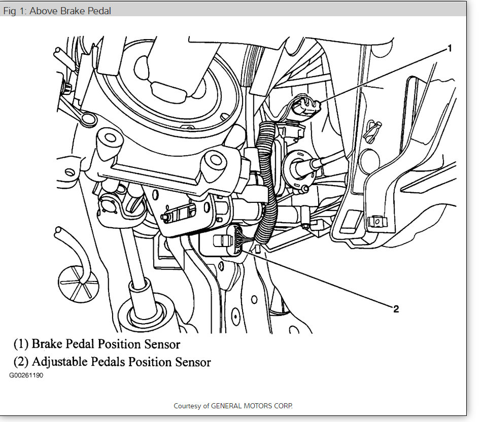

This is what the switch I'm talking about looks like. it's the only switch I see. on the 2006 have they combined the sensor that allows you to shift out of park with the sensor for the rear brake lights? this is the only switch I see that is affected by pressing the brake pedal.
https://images.2carpros.com/forum/automotive_pictures/228923_untitled_1.jpg
this switch is NOT mounted on the brake pedal or lever. it is to the left about 6 or 8 inches, and is rotated by a metal rod that sticks off the side of the brake pedal lever and inserts between the two arms on the above switch.
Jan 6, 2020 at 4:23 AM (Merged)
  • 75,992 POSTS
Disconnect the switch and observe the brake lights-The brake switch/sensor are use to control other function such as the cruise control and shift interlock

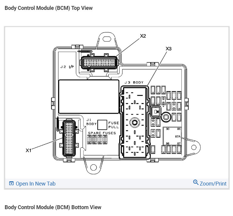

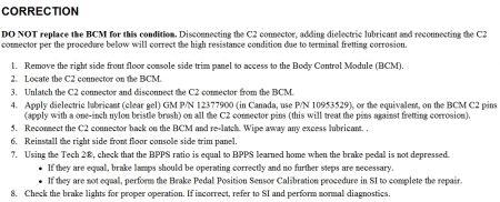

I know this question is old but hope someone may be able to use this.
#08-05-22-009: Intermittently Brake Lights (Stop Lamp) Do Not Function Correctly, Extended Travel to Shift Out of Park, Cruise Control Inoperative, DTC C0161/C0277 Set (Perform Repair as Outlined) - (Dec 4, 2008)
Subject: Intermittently Brake Lights (Stop Lamp) Do Not Function Correctly, Extended Travel to Shift Out of Park, Cruise Control Inoperative, DTCs C0161/C0277 Set (Perform Repair as Outlined)
Models: 2004-2007 Chevrolet Malibu, Malibu Maxx
2008 Chevrolet Malibu Classic
2005-2009 Pontiac G6
2007-2009 Saturn AURA
Condition
Some customers may comment that intermittently the brake lights do not function correctly. Other symptoms may include extended pedal travel required to shift out of PARK, cruise control does not function correctly, and DTC C0161 and/or C0277 may be set.
Cause
The most likely cause of this condition is high resistance due to terminal fretting corrosion in the body control module (BCM) C2 connector (specifically pins C2-18, C2-31 and C2-59).
Correction

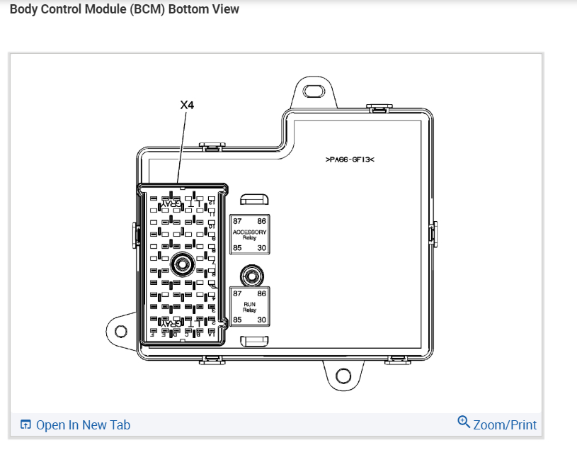

DO NOT replace the BCM for this condition. Disconnecting the C2 connector, adding dielectric silicone grease and reconnecting the C2 connector per the procedure below will correct the high resistance condition due to terminal fretting corrosion.
Remove the right side front floor console side trim panel to access to the Body Control Module (BCM).
Locate the C2 connector on the BCM.
Unlatch the C2 connector and disconnect the C2 connector from the BCM.
Reconnect the C2 connector back on the BCM and re-latch.
Repeat Steps 3 and 4 (this step cleans up the terminal fretting corrosion).
Using the Tech 2®, verify the brake pedal position sensor (BPPS) voltage is between:
• 0.88V - 2.11V (for 2004-2006 model years)
• 0.73V - 1.47V (for 2007-2009 model years)
Check for proper operation of the brake lights.
• If the brakes lights are operating properly, remove the C2 connector again from the BCM and proceed to Step 8.
• If the brake lights are not operating properly, proceed to Step 12.
Apply dielectric lubricant (clear gel) GM P/N 12377900 (In Canada, use P/N 10953529) on the BCM C2 pins (apply with a one-inch nylon bristle brush) on all the C2 connector pins (this will treat the pins against fretting corrosion).
Reinstall the right side front floor console side trim panel.
Using the Tech 2®, check that the BPPS ratio is equal to BPPS learned home when the brake pedal is not depressed.
• If they are equal, brake lamps should be operating correctly and no further steps are necessary.
• If they are not equal, perform the Brake Pedal Position Sensor Calibration procedure in SI to complete the repair.
Check the brake lights for proper operation. If incorrect, refer to SI and perform normal diagnostics.
Source(s):
gm tech

I would be replacing the brake light switch which is mounted on the top of the brake pedal under the dash.

I have the same problem but I see no switch at the top of the brake pedal. there is only a round white switch to the left of the brake pedal lever, that is turned by a metal rod that sticks about 6 inches off the left side of the brake pedal lever.
Jan 6, 2020 at 4:24 AM (Merged)
CHALL52
  • 9 POSTS
Yes that is your brake switch. I've replaced mine and it did not fix it.
