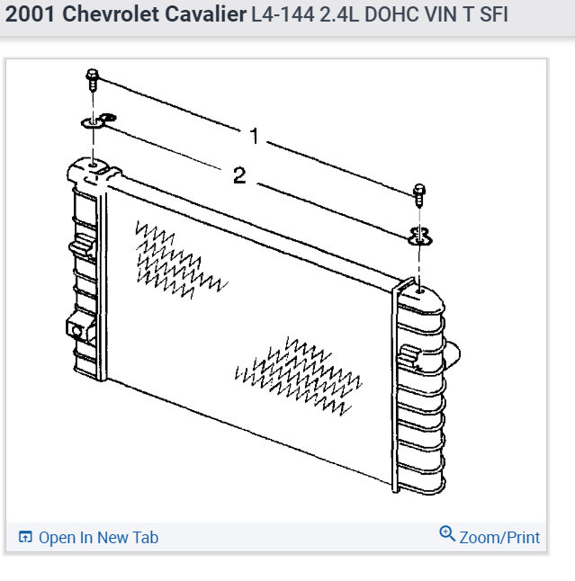

Where is the actual rad cap located on a 2001 Malibu? I see the surge tank and cap but where/how do I access the rad cap? I have a coolant leak and want to ad a stop leak product until I can get it to the shop. The stop leak product advises to only ad directly into the rad....not the surge tank.
thanks
Nov 26, 2006 at 7:08 AM
JDL
  • 16,098 POSTS

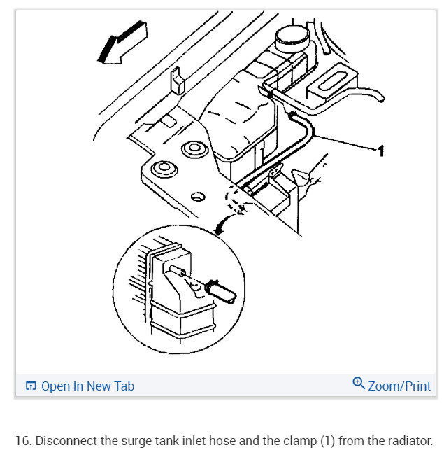

Some radiators don't have a radiator cap this is one of them here is diagrams that show the system and the radiator cap which is on the coolant reservoir. If the stop leak need to be added to the radiator you will need to remove the upper hose pour it in that reinstall the hose and refill the system.
Check out the diagrams (Below). Please let us know if you need anything else to get the problem fixed. Cheers

You may not have a radiator cap, in that case, if coolant is low add coolant to the radiator surge tank. Check coolant level with everything cold. Don't remove the surge tank cap on a hot engine. The surge tank is under the hood on the passenger side of engine compartment.
