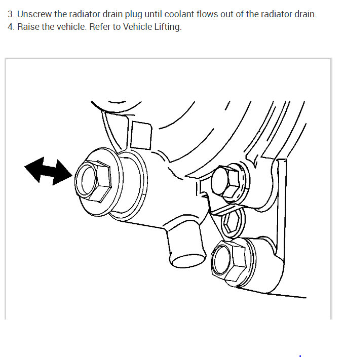

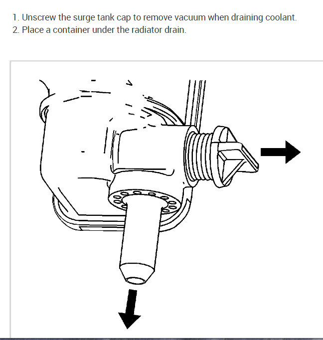

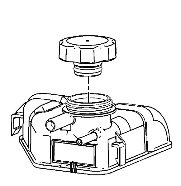

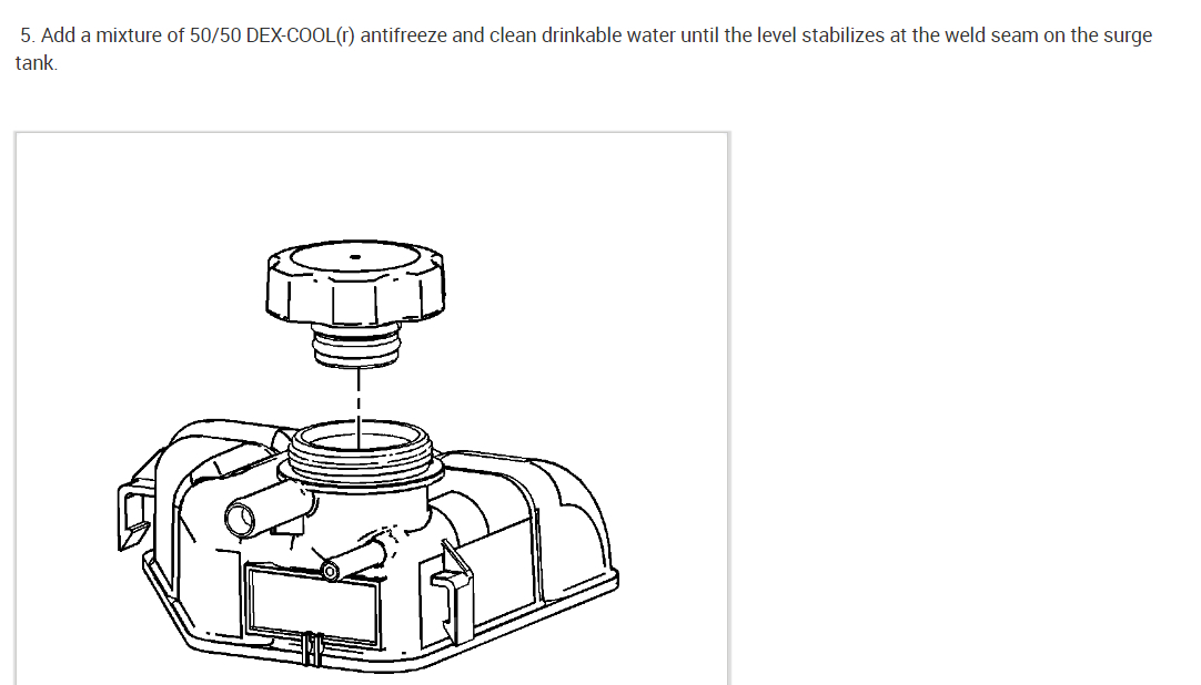

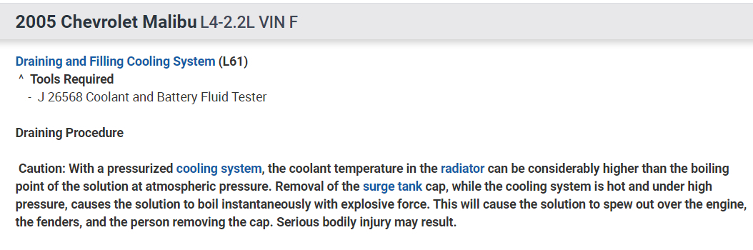

I removed the splash shield below the radiator, but I can't find a radiator drain valve. I am trying to drain, flush, and refill with fresh coolant. I even removed the tube fitting at the bottom on the passenger side of the radiator and vented at the top, but no coolant poured out.
Jul 2, 2010 at 8:08 AM
DANNY L
  • 5,648 POSTS
Hello, I'm Danny.

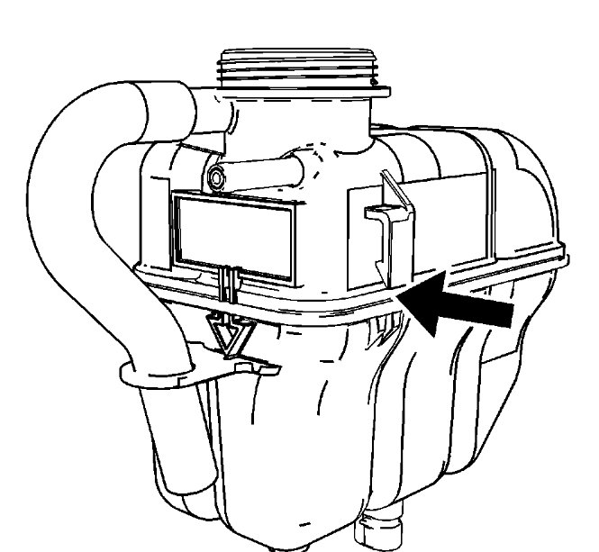

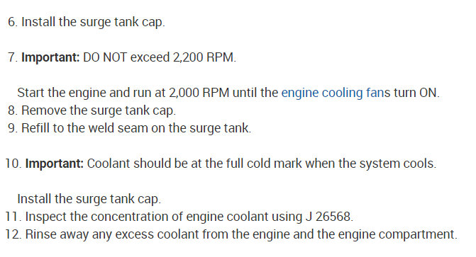

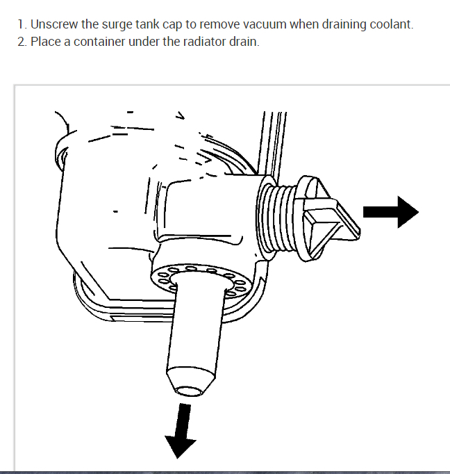

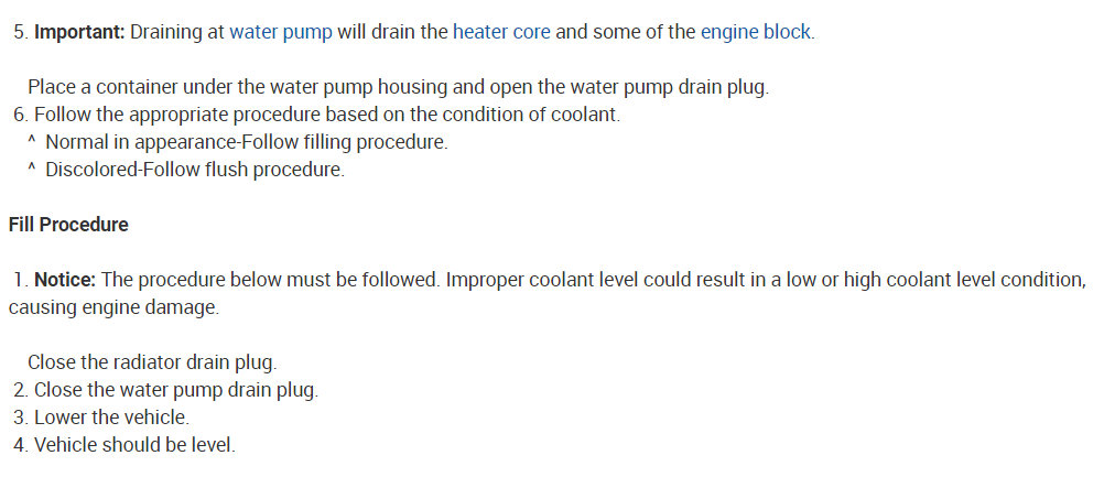

Here this the information you've requested. This is tutorial showing what is involved for a coolant drain and fill.
https://www.2carpros.com/articles/coolant-flush-and-refill-all-cars
I've attached picture steps below for your car including the drain valve location. Hope this helps and thanks for using 2CarPros.
