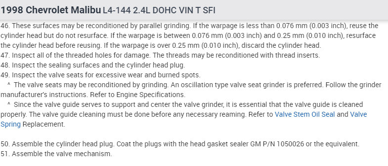

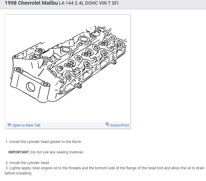

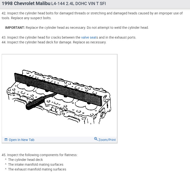

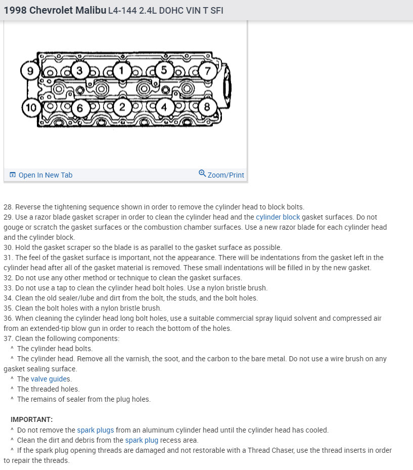

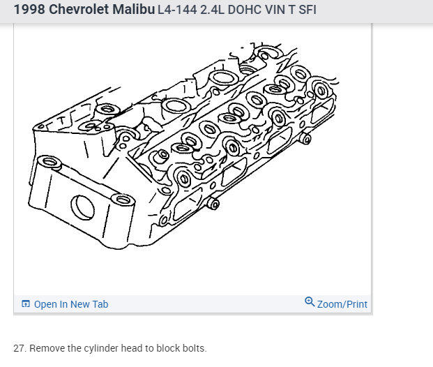

Keep in mind that those chemical sealers do not always work. It will depend on the severity of the blown head gasket. If the head is wrapped the chemical sealer will not work.
The odds are that even if you use this sealer again it will not work.

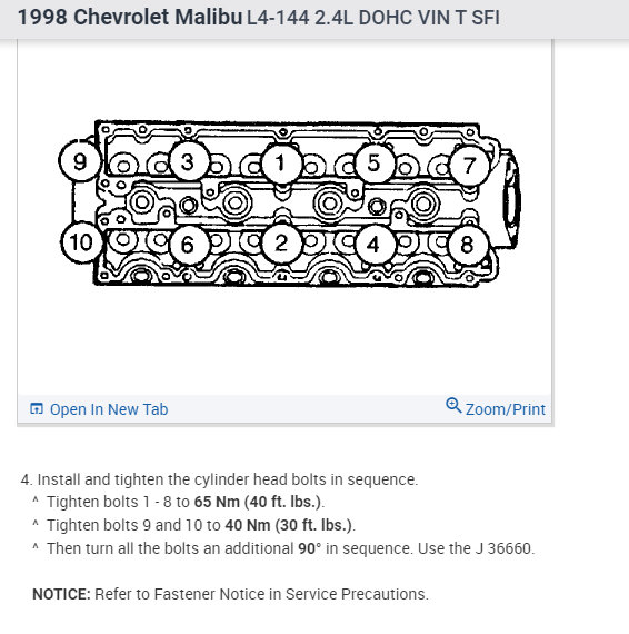

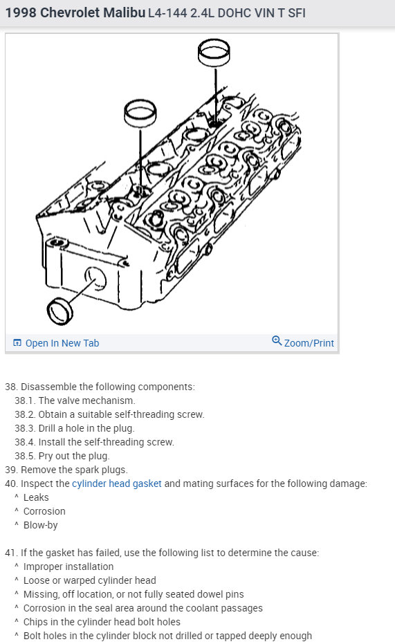

So it appears that the real solution would be to replace the head gasket and inspect the cylinder head and the block. It might even need machining of the head if there is unevenness.
We have a very good video that talks about these types of chemical sealers:
https://youtu.be/Xi41RFMP8Ow

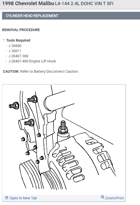

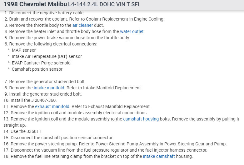

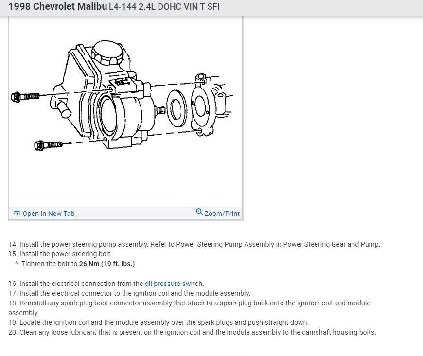

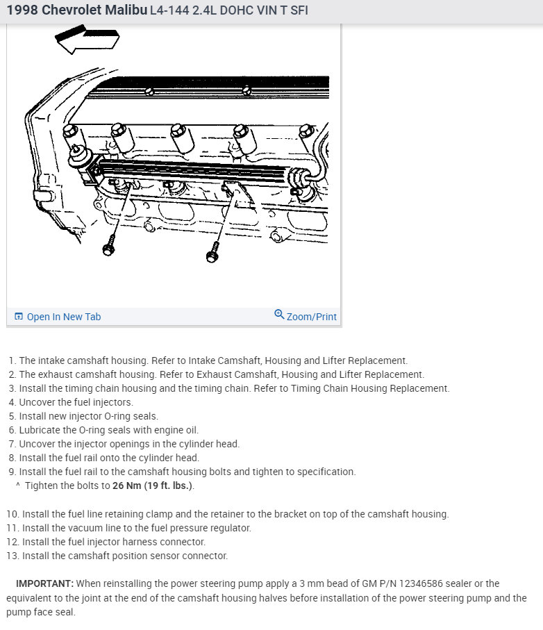

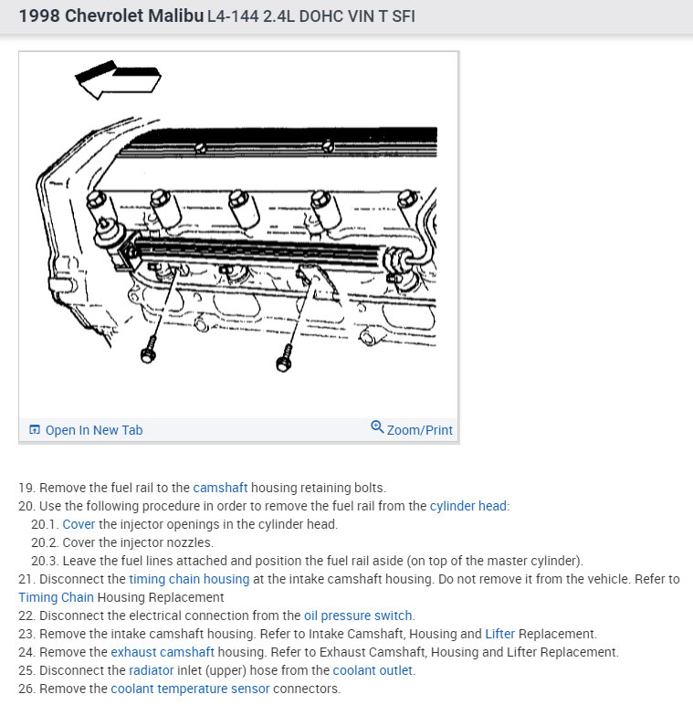

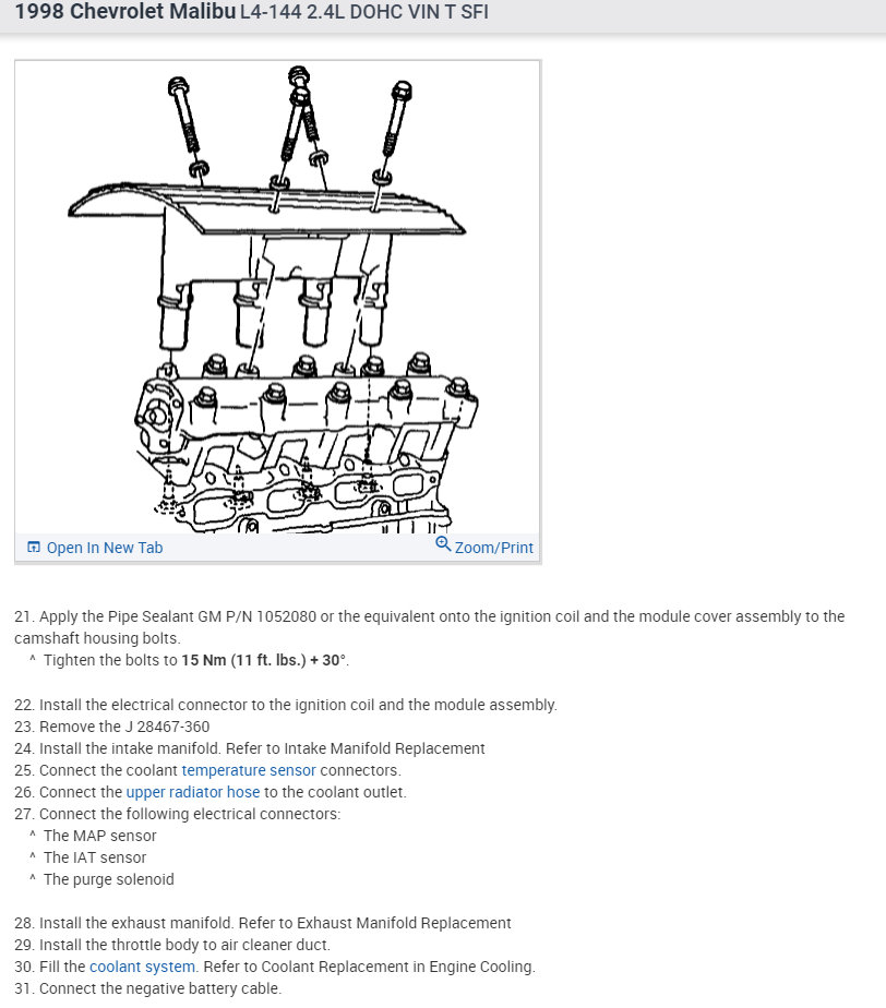

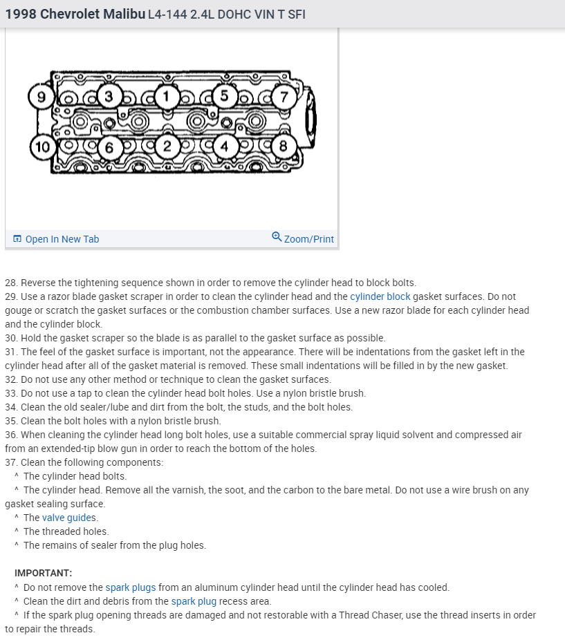

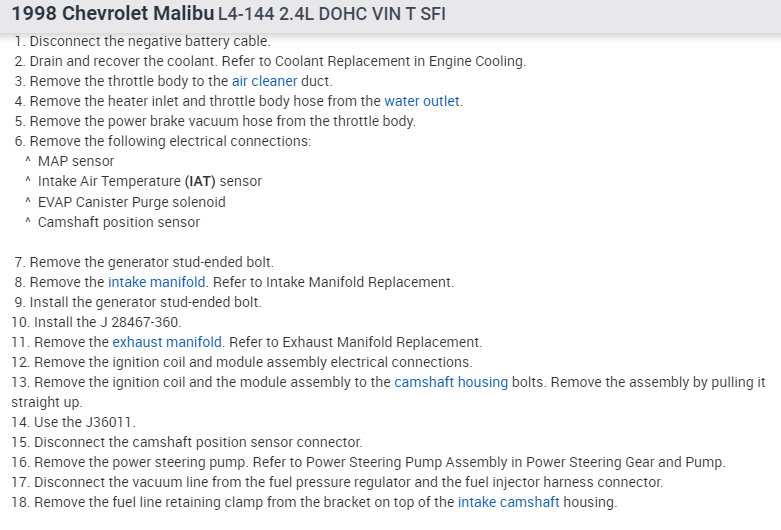

I have attached diagrams of head gasket replacement for your reference.
