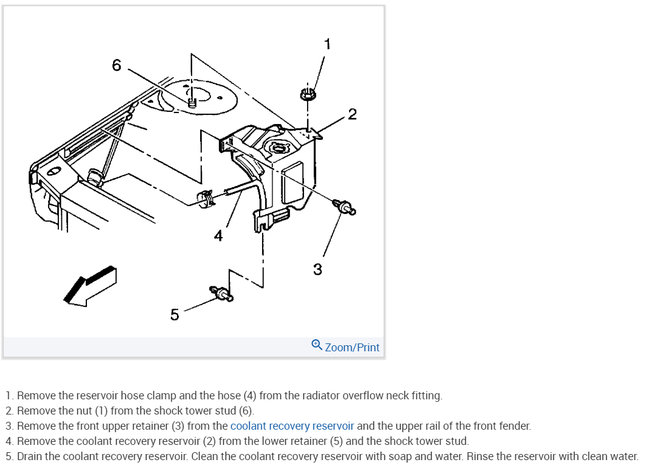

There is a sensor in the coolant recovery tank that has gone bad you may need to replace the tank as a unit ehre is a guide to help you see what you are in for when doing the job.
https://www.2carpros.com/articles/coolant-reservoir-replacement

Image (Click to enlarge)
