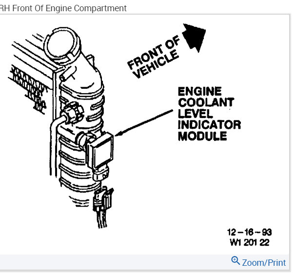

My low coolant light blinks from time to time. I am not low on coolant and the car does not overheat. Please advise of what the problem may be.
May 30, 2008 at 2:10 AM
DNAPRORACING
  • 120 POSTS
There is a sensor is about $38.00 on the side of the radiator that needs to be replaced. Here is a guide to show you how to drain the coolant before you begin:

The level sensor attached to the bottom of the coolant tank is probably faulty and sending false signal.

Have you checked the sensor and its wiring? Should be near the top of the radiator. If you have an ohmmeter, you might check the sensor and replace if resistance is infinite.
