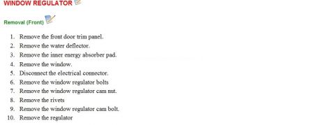

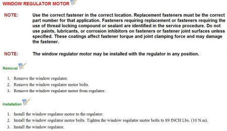

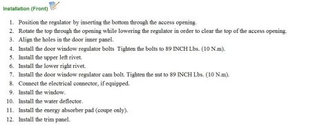

How do I change Power Window Motor Front Driver Side?
Thursday, October 28th, 2010 AT 5:28 PM
BLUELIGHTNIN6
MECHANIC
16,542 POSTS
SPONSORED LINKS
Thursday, October 28th, 2010 AT 6:23 PM
