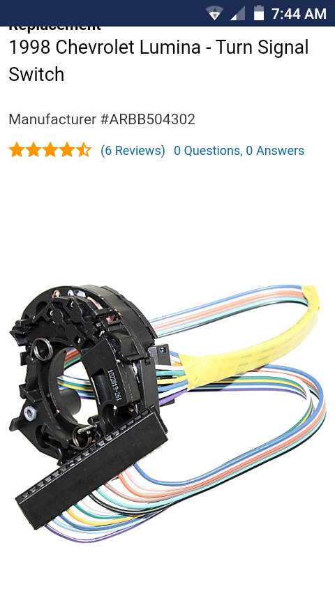

If the brake light switch on the pedal is properly adjusted and working, the switch on the steering column that you touch must be bad.
I would recommend having the signal switch checked by an auto electric mechanic.

1998 Chevy Lumina LS Sedan
My lower brake lights weren't coming on. Mechanic relaced the multifunction arm, this did not fix issue. Different mechanic replaced a round ring-like switch located inside the steering column, that the multifunction arm plugs in to. This fixed the issue, lights are now coming on.
