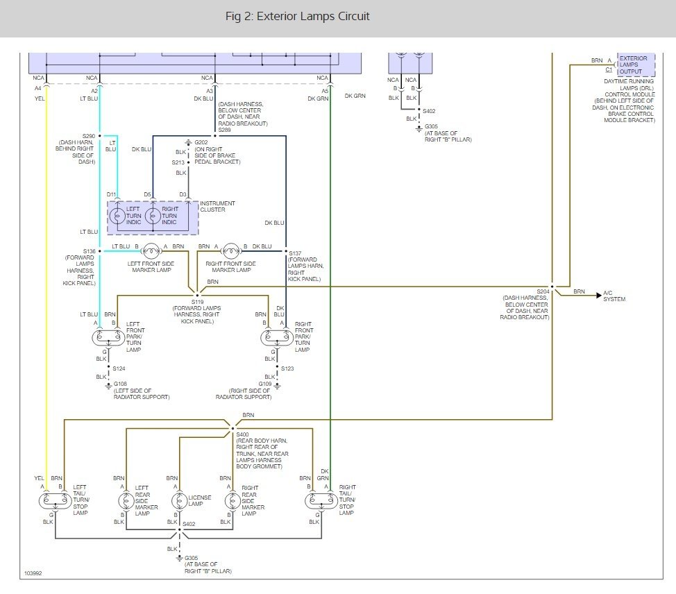

This sounds like you have a turn signal switch that has gone bad. Here is a wiring diagram of the brake lights and a guide so you can do some testing to confirm the failure.
Please run some tests and get back to us we are interested to see what it is.

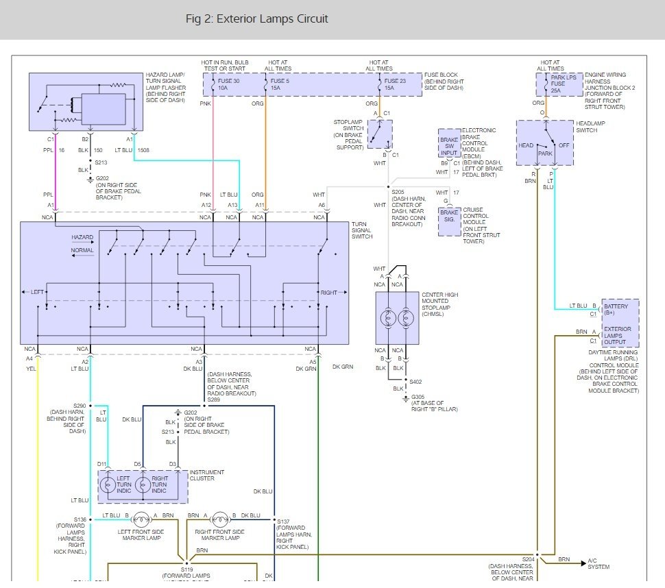

Check the brake switch, and voltage to and from switch. Orange wire is voltage to the switch, hot all the time. White wire goes hot when switch is activated, carries voltage for brake lites. Switch should be under the dash, activated by brake pedal arm.

Is there voltage on the white wire? The high-mount brake lite, while it does get voltage from the brake switch, it is not wired the same as the lower brake lites. The lower brake lites are wired through the turn switch. Did you use a testlite on the bulb socket, brake switch activated. Did you check for voltage on the wiring colors already mentioned?

if brake switch, fuses and bulb are all good and high mount brake light works then suspect faulty turn signal (multi function) switch. main brake lights run through turn signal switch, high mount brake light runs through separate circuit on a relay switch.

I have a 1998 Chev Lumina and the rear brake lights and turn signals dont work. The running lights in the rear are ok and the upper rear deck brake light works when you press the brake pedal, but not the rear. If you try to wire in the tail brake lights directly from the working deck brake light, the electrical system goes wacky, for example the door locks go up and down.. Is the problem in the turn signal multi functional device or is the problem more serious?? (the bulbs have been changed)
Aug 15, 2020 at 4:13 AM (Merged)
  • 75,992 POSTS
The power to the turn signals and brake lights comes from the turn signal switch-if it malfunction you won't have the lights.

The parking lights get turned on thru the head light switch the turn signals get turned on thru the turn signal switch.Then the brake lights get turned on thru brake switch.So what were you asking?Do you have a multi meter and test light?

Check fuse no.23 15amp in the fuse block behind right side of dash if okay -find the brake switch and check for power on the white and orange wire with a test lite-while brake pedal is depress-both should have power if the white don't have it-replace the brake switch or check adjustment-if the okay test the turn and hazard switch the brake circuit goes thru this switch before it gets to the back-
