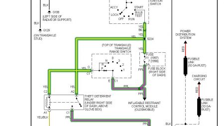

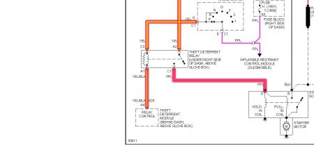

If you're trying to say it won't crank over when you turn the key to starting position-check and test the theft deterrent relay and the theft deterrent module located behind the dash above the glove box.
https://www.2carpros.com/forum/automotive_pictures/12900_atd_1.jpg

My first thought was the neutral switch. Second, the theft system. When it refuses to start, is the theft lite doing anything?
+1
Sunday, April 26th, 2020 AT 3:15 PM (Merged)
TECH9
Thanks for the quick reply.
When you mentioned security system, I broke out the owners manuel. The cars comes equipped with a security key. If it is damaged or the wrong key, it will shut down the starter and fuel systems for about 3 minutes. That's why it started when I switched keys.
I believe that's the problem.
Thanks for your help.

  • 75,992 POSTS
Check no.7 fuse 5amp, transaxle range switch and theft deterrent relay-
https://www.2carpros.com/forum/automotive_pictures/12900_transaxle_range_switch_1.jpg
Sunday, April 26th, 2020 AT 3:16 PM (Merged)
