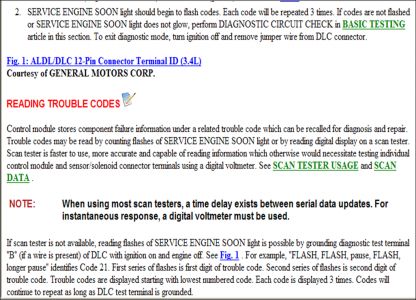

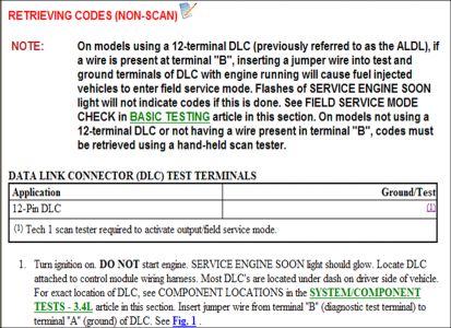

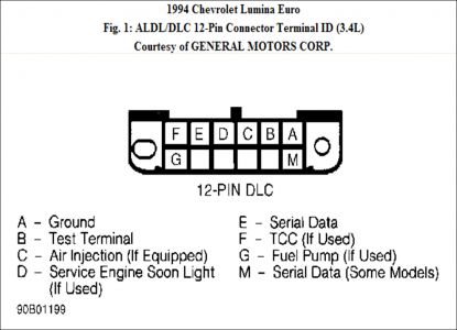

IMPALASS
  • 3,112 POSTS
Hello
Alright - I have attached how you check for codes. See if it makes sense to you. The big thing. . .DO NOT START THE CAR.
You basically put say a paper clip and jump A and B pin together. You turn the car on to where the lights come on ONLY. . ..DO NOT START.
Watch your check engine light
The first flash is the first number and the second flash is the second number. So you sit with paper and count the flashes. It will flash the same number 3 times then go to the next if there is one. It should always start with 12. So for 12 it will be:
Flash (1) pause flash, flash (2) longer pause. . ... Flash (1) pause flash, flash (2) longer pause . . . Flash (1) pause flash, flash (2) longer pause
Now from this point on watch and count the other numbers. Say it is 31. It would be:
Flash, Flash, Flash (3) pause flash (1) longer pause. . .. Flash, Flash, Flash (3) pause flash (1) longer pause. . .. Flash, Flash, Flash (3) pause flash (1) longer pause. . ..
Again - I can not stress enough. . ...DO NOT START THE CAR. The second you see it repeating it self, turn the car off and remove the jumper wire.
I have attached the manual test and explained above. Let me know what codes you come up with.
If you have a question - please ask. Then we will take it from there.
