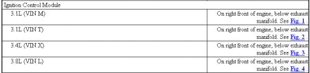

MERLIN2021
  • 17,250 POSTS
I agree Jack, also the weak link could be the ignition control module, or connections to it. Here's the locations by engine size and VIN:
https://www.2carpros.com/forum/automotive_pictures/62217_Luma_1.jpg
