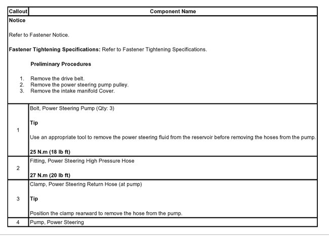

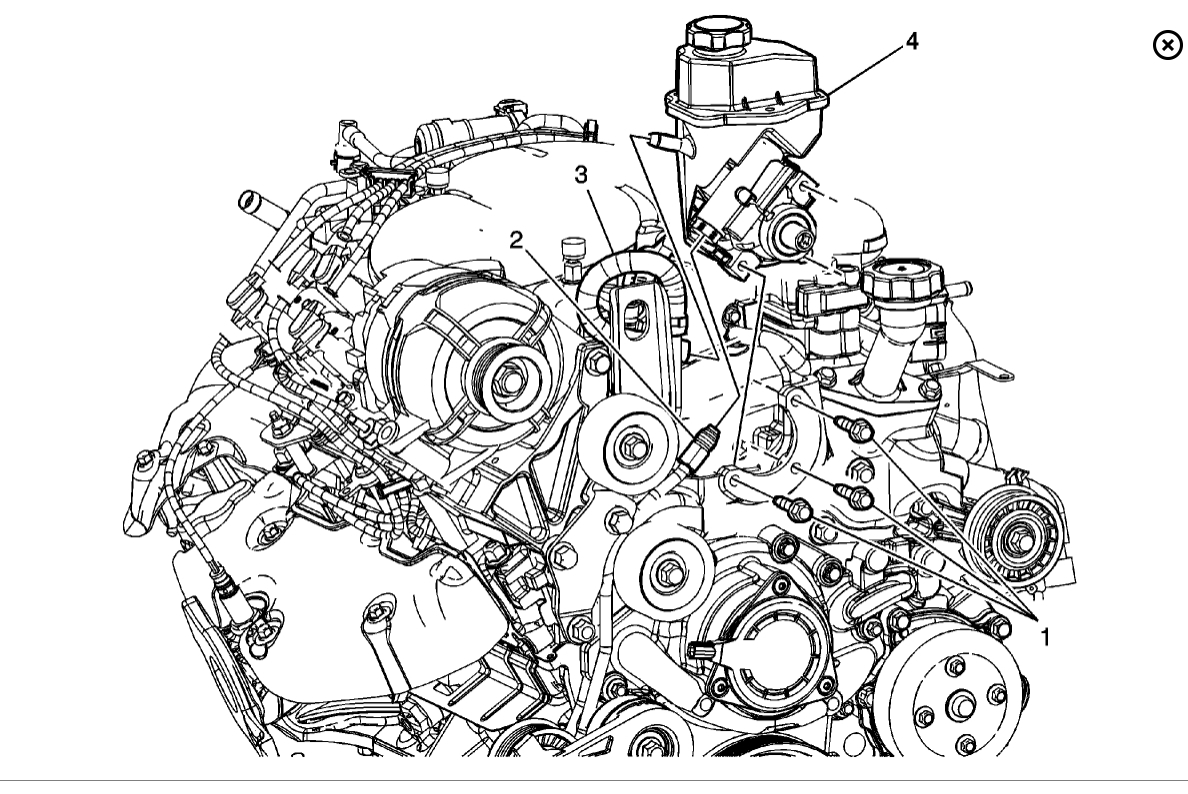

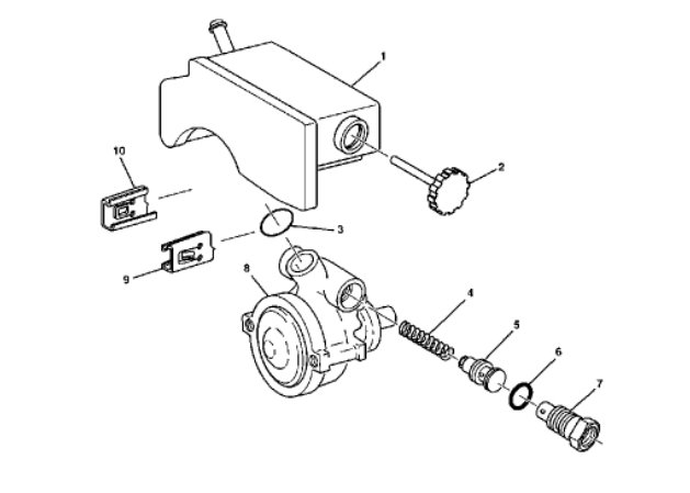

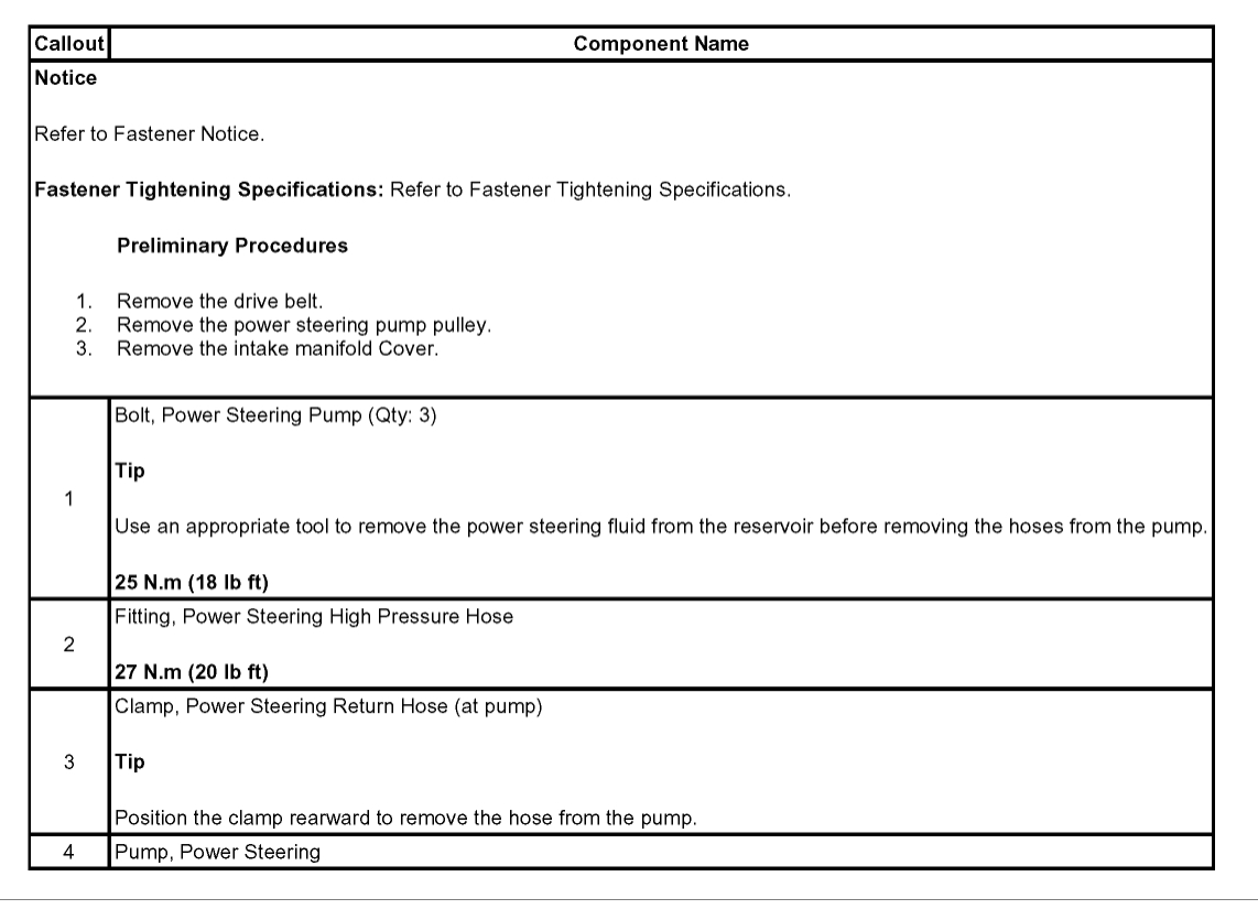

whining noise when turning
2006 CHEVROLET IMPALA
NICHOLASMYLOVE2002
Steering problem 6 cyl Front Wheel Drive Automatic 30,000 miles
Recently had power steering pump and rack and pinion replaced also tire rod and serpentine belt replaced. now noticing a loud whining noise when you turn the wheel either direction. why is it making this very loud and annoying whining noise?
Apr 30, 2010 at 3:34 AM
  • 55,433 POSTS
This noise is caused by the power steering system sucking in air from the power steering pump. The seals from the reservoir to the pump are bad allowing air into the system. To fix this problem you will need to replace the pump with a AC delco unit.
Here is a guide to show you what you are in for when doing the job
https://www.2carpros.com/articles/how-to-replace-a-power-steering-pump
Here is how it can be done on your car (below)
