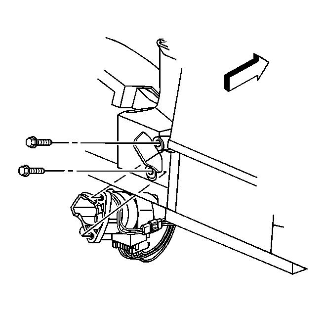

I couldn't get my hand up to the back of the switch, but I did try poking it w/a stick.
No change.
So, I guess it's internal, & I should change the key switch?
If so, how the heck do I get to it?
Is there a way to "jump" the switch before taking apart or working on the dash?
I have NO problems w/even alligator clips, for testing.
(I REALLY miss my '63 Galaxy, '65 Impala, & my '68 Dart GTS!)
Mac
Sunday, May 17th, 2020 AT 11:23 AM (Merged)
DOCFIXIT
  • 18,828 POSTS
No switch burried need to pull colum apart remove key cylinder, air bag steering wheel and drill out switch screws. Ie. Big job

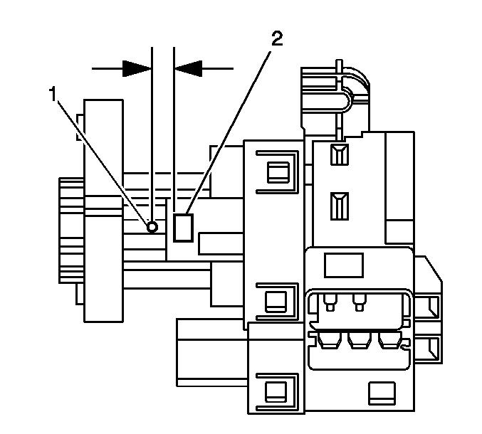

My switch is on the dashboard, not the column. Makes it a LOT easier on me.
Do you have a link to a free online electrical schematic I could use to figure out the wiring to the key plug in and driver side fuse box?
I've spent hours & hours tryin' to find one w/no result.
I'll temporarily "hard-wire" (w/an extra fuse of course) my A/C, while waiting for my new switch and cd factory repair manual. I live way out in the Mojave Desert, so theft isn't a problem, heat IS.
+1
DOCFIXIT
  • 18,828 POSTS
Forgot chevy moved to dash get back to removing knee panl and got to key cylinder. Plug on bottom see diagram find ORANGE wire term C1 post F6 that is to AC find hot wire tap into.

Saved my pennies & FINALLY bought the stock switch 'bout a week ago.
You were absolutely RIGHT-THANK YOU!
R&R was easier than I expected, due to your instructions.
AC & cruise problems went away.
