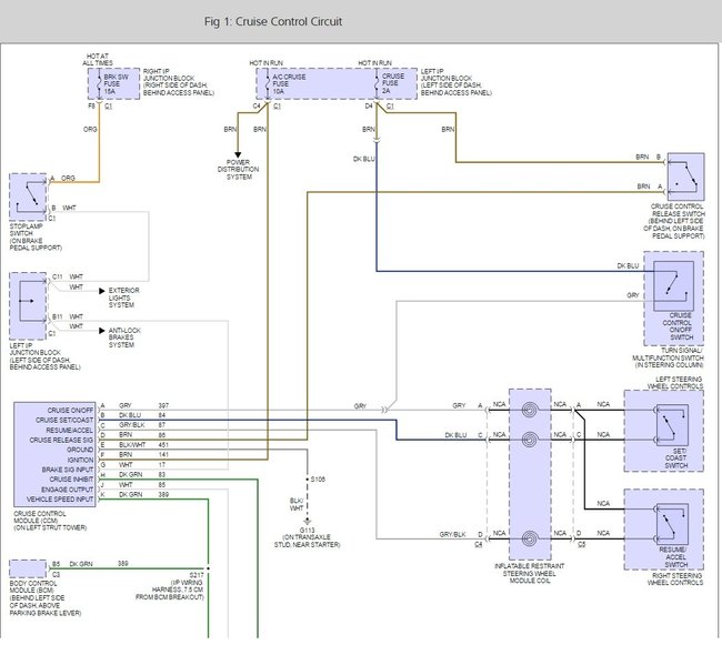

Is the cruise control on the 2005 Chevy Impala a module that I can replace or is it more involved? If it is a module, where can I get the part number and about how much would it cost?
The light on the dash does not come on. I press the button on the steering wheel, but nothing happens.
Nov 10, 2008 at 11:15 AM
  • 55,628 POSTS
Hey ANG74,
I would test the fuse first to see if it is good.
Here is a guide that will help you.
There is a wiring diagram at the bottom of this post.
If that tests okay here is a a trouble tree, please follow:

Schematic Reference: Cruise Control Schematics
1 Did you perform the Diagnostic System Check - Vehicle?
2 Raise the vehicles drive wheels. Refer to Lifting and Jacking the Vehicle in General Information.
Start the engine.
Place the transmission into drive.
Observe the speedometer in the instrument panel cluster (IPC).
Does the speedometer operate properly?
3 Turn the ignition OFF.
Disconnect the cruise control module.
Turn the ignition ON, with the engine OFF.
Connect a test lamp between the ground circuit of the cruise control module and battery voltage.
Does the test lamp illuminate?
Yes - Go to Step 4
No - Go to Step 27

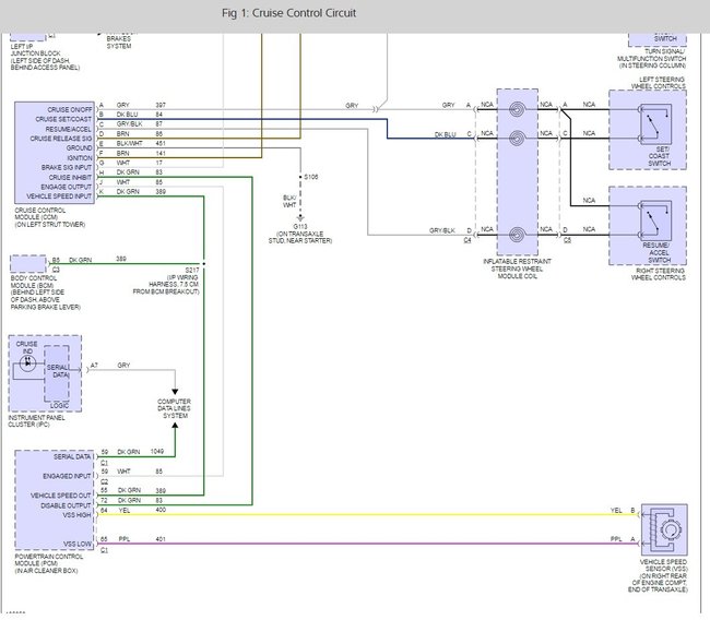

22 Test the vehicle speed signal circuit for an open or for a high resistance between the cruise control module and S217. Refer to Circuit Testing and Wiring Repairs in Wiring Systems.
Did you find and correct the condition?
Yes - Go to Step 32
No - Go to Step 23

26 Inspect for poor connections at the harness connector of the cruise control module. Refer to Testing for Intermittent Conditions and Poor Connections and Connector Repairs in Wiring Systems.
Yes - Go to Step 32
No - Go to Step 31

What causes the cruise control to not set but the power light comes on but it doesn't set
Jan 2, 2017 at 9:21 AM (Merged)
HOMER1967
  • 875 POSTS
does the horn blow?does the transmission shift normaly?any check engine lights on?

Yes all that work perfectly find
HOMER1967
  • 875 POSTS
it could be anything from a wheel speed sensor to an input or output sensor to an electrical issue.i would have to suggest that you take it to a shop and have it diagnosed.because there are a lot of very specific tests that will need to be done to get to the root cause.
