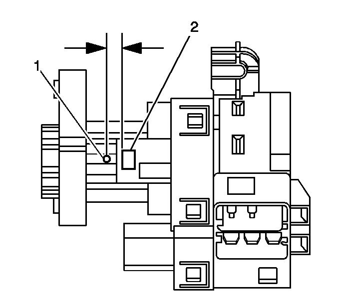

All circuits you say have no power are feed by ignition switch

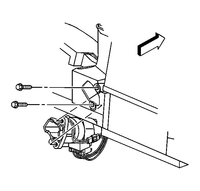

DOCFIXIT
  • 18,828 POSTS
No switch burried need to pull colum apart remove key cylinder, air bag steering wheel and drill out switch screws. ie. big job

  • 8 POSTS
My switch is on the dashboard, not the column. Makes it a LOT easier on me.

DOCFIXIT
  • 18,828 POSTS
forgot chevy moved to dash get back to removing knee panl and got to key cylinder. Plug on bottom see diagram find ORANGE wire term C1 post F6 that is to AC find hot wire tap into.
