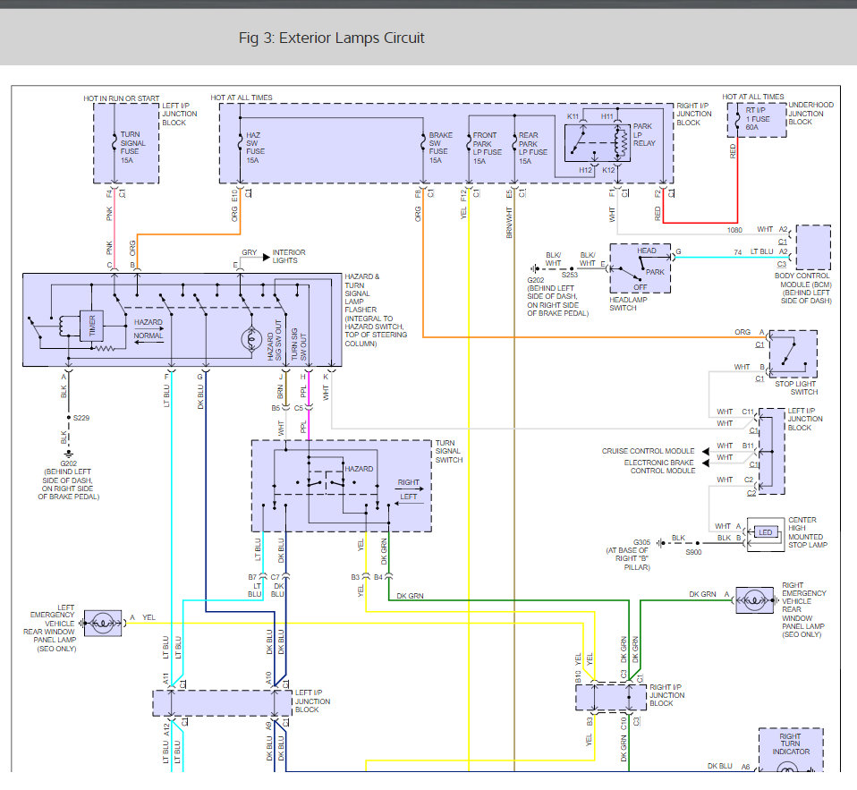

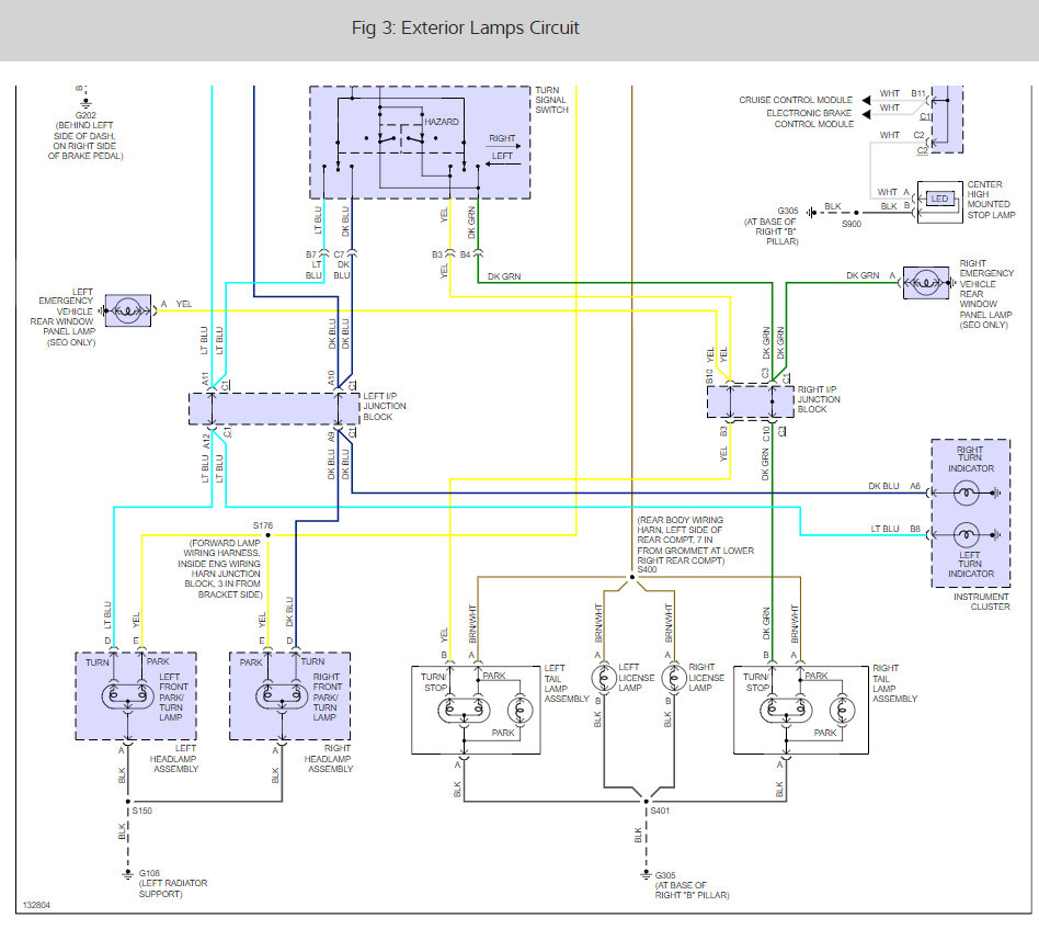

I need to locate the turn signal flasher on my 2005 Chevy Impala. I have looked under the dash and cannot seem to find it.
Mar 10, 2009 at 8:14 AM
LSAUTO
  • 61 POSTS
It is a black box with a 2 or 3 wire plug-in. Check out the diagrams (Below). Please let us know if you need anything else to get the problem fixed.
Mar 10, 2009 at 11:55 AM

The flasher is interrogated into the hazard switch and some have a separate flasher than the Hazard switch. Located in the dash behind instrument panel cover above steering column. Check out the diagrams (Below). Please let us know if you need anything else to get the problem fixed.

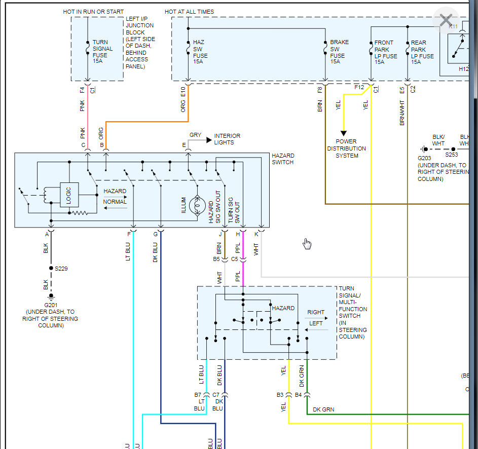

they are either part of the hazard switch or controller by the switch.
Nov 2, 2020 at 7:15 AM (Merged)
TWELVEPAWZ

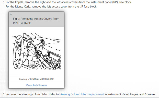

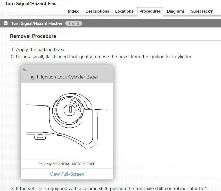

How do I access the Signal Flasher Relay? (Part of Hazard Switch?)
  • 75,992 POSTS

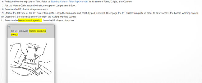

You have to remove the hazard switch and replace it-its built-in.
BLUELIGHTNIN6
  • 16,542 POSTS

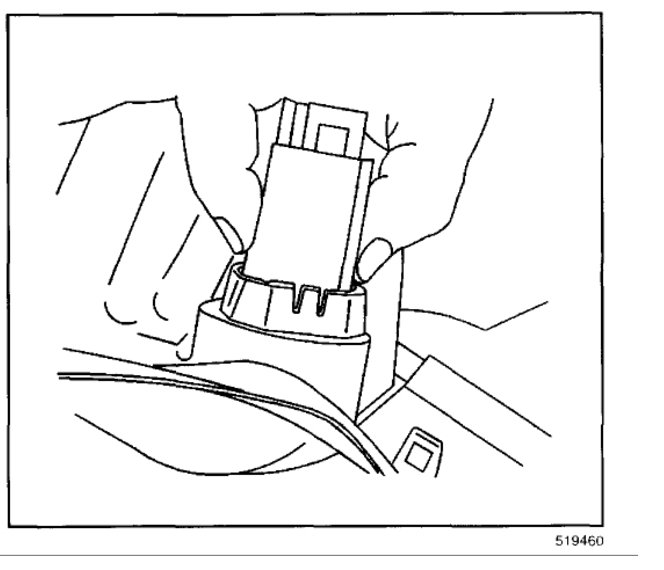

take a flat head screw drive and pry the hazard button off. This will break the old switch but it will expose the part so you can get it out. Take the same Medium size flat head and slide it next to the switch at the 4 o'clock position, take a needle nose and grab the switch in the middle. By pulling on the switch and wedging the screw driver between the dash and the switch you will be able to release one side of the switch from the dash. Now without letting go of the switch with the needle nose, take the screw driver and wedge it in at the 11 o'clock position. This will release the other side of the switch. Give it a pull and the whole thing will come out of the dash. Disconnect the wires via the plug being careful not to let the wires pull back into the dash and plug in new switch. Then simply slide switch in the opening and it will click into place

check fuse labeled turn signal (15 amp) in the left instrument panel fuse block. most likely it is the relay though, it is actually part of the hazard switch, left center of instrument panel.

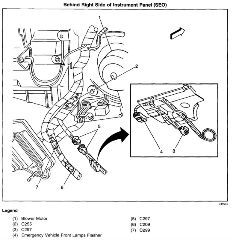

  • 55,432 POSTS

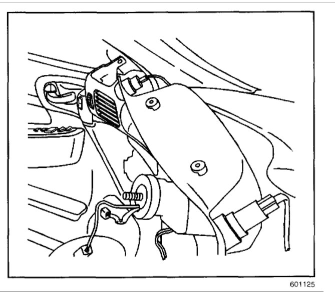

The turn signal flasher is integrated into the hazard flasher and is located under the dash on the passengers side or in the hazard switch itself. Here is a wiring diagram and location (below) so you can get the problem fixed and some location and how to diagrams.
Here is a guide so you can do some testing

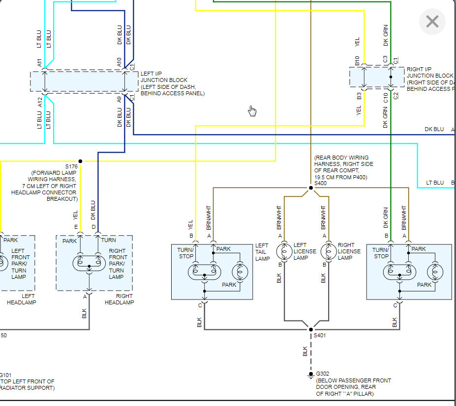

I have a 2006 Chevy Impala LTZ that I put LEDs in, it fast blinks and clicks when using the left and right turn signal, but blinks and clicks normal for the hazards. I have not been able to locate the flasher relay. Please Help!
Dec 27, 2024 at 8:10 AM
  • 55,432 POSTS
You must install the LED that have the resistor built in, the flasher part of the lighting is handled by the BCM there is no separate flasher unit.
