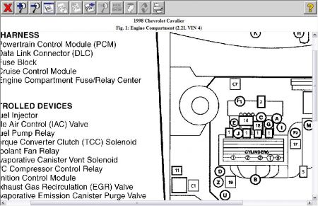

Disconnect a sparkplug wire at the plug end and ground it to the engine while cranking it over do you have spark? No spark ---Check the Camshaft and Crankshaft postion sensors. Start with the CPS at E see below
https://www.2carpros.com/forum/automotive_pictures/12900_1999_chevy_cavalier_CPS_1.jpg
