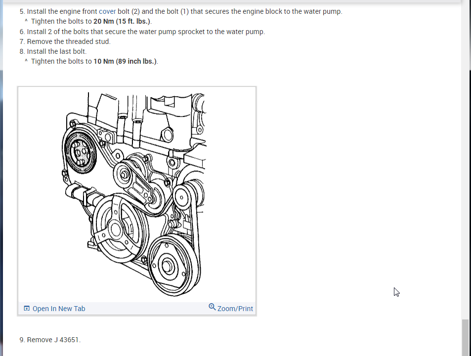

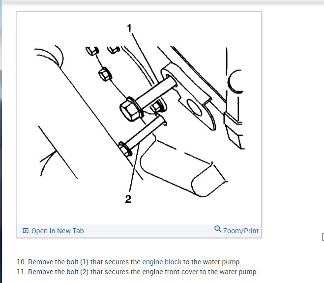

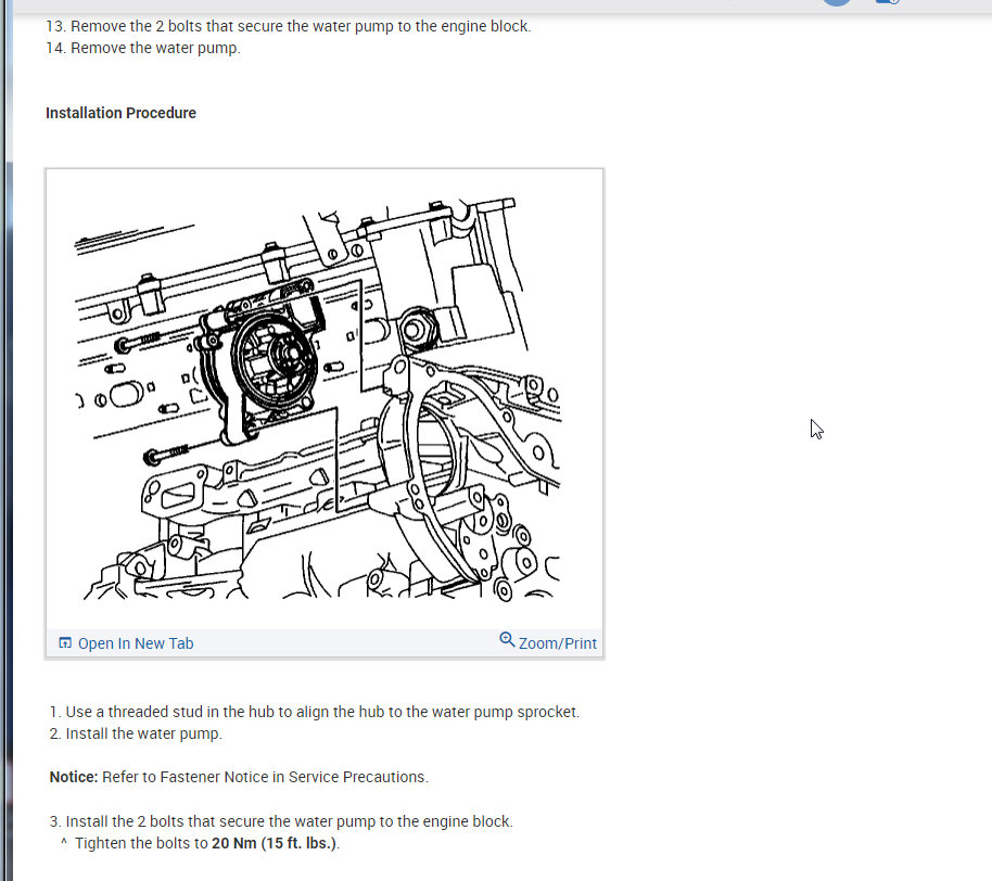

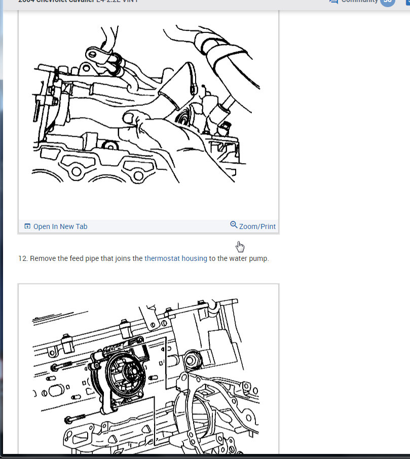

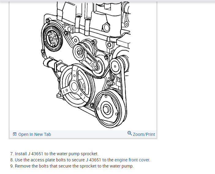

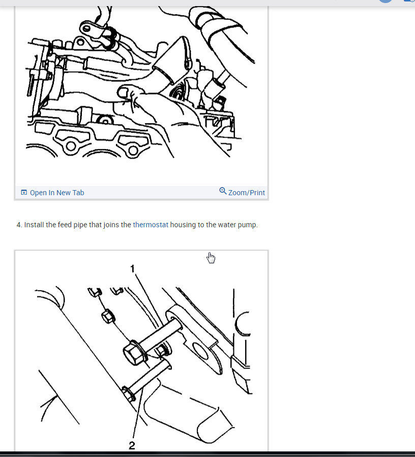

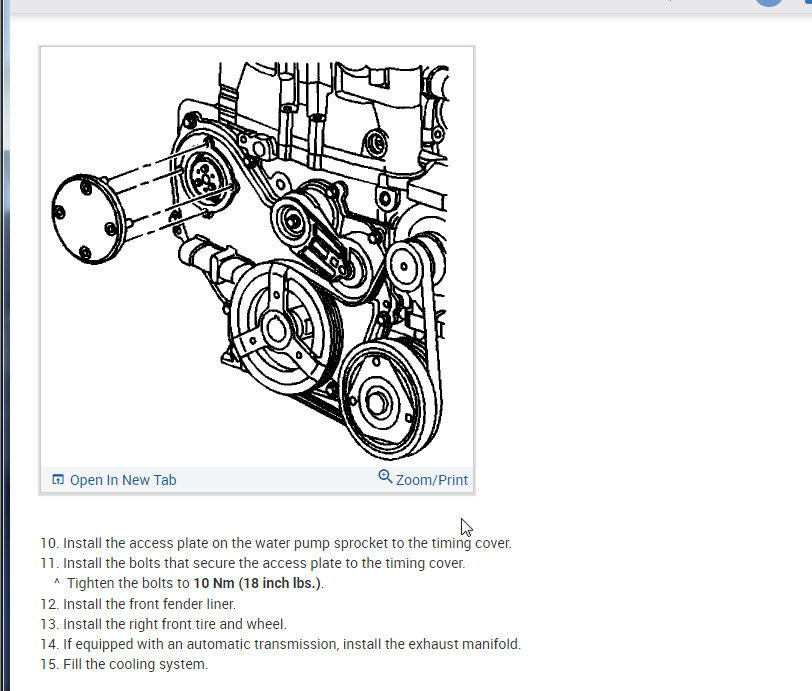

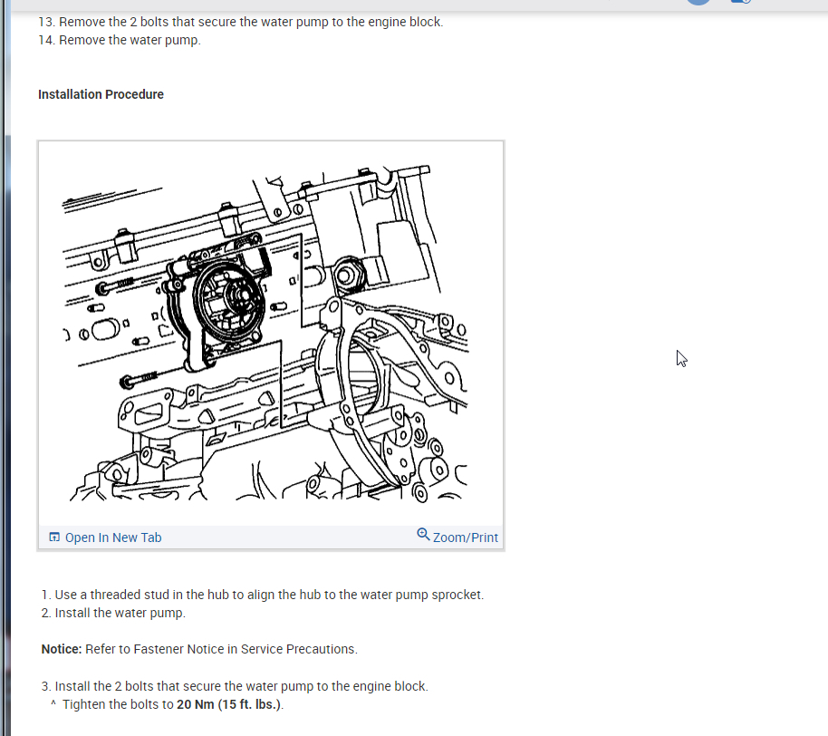

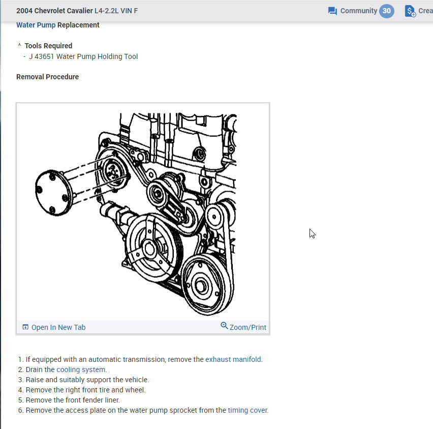

What are the step by step directions on how to replace a water pump on the car listed above?
Thursday, February 18th, 2010 AT 6:50 PM
MECHANIC
18,907 POSTS
I am attaching the info from the manual on how to replace it. Let us know if you need more info. Thanks
