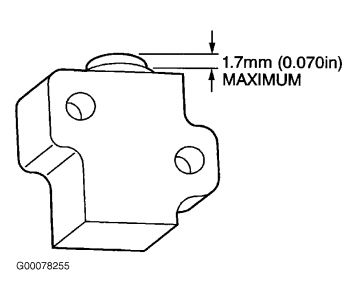

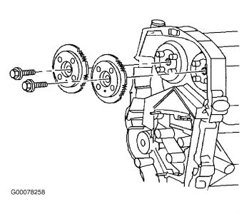

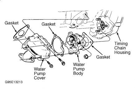

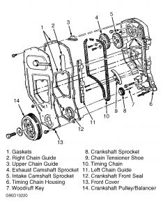

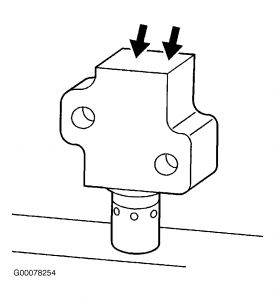

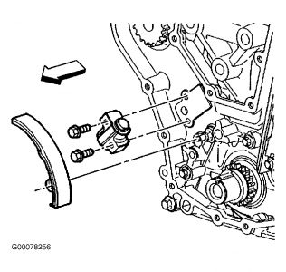

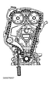

I guess the subject sums it up. How do I change a water pump in a 2.4?
Thanks for your help

Thanks for the info, can I bother you for an exploded view of the job?

You are awsome thank you
