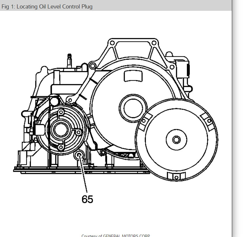

I want to check my transmission fluid. There is no dipstick. Where do I check it at, how do I fill it, and what kind of fluid do I use (just any kind?). There is a cap for what looks like gear oil (?) too. Has a "gear" symbol on it. What is it and do I need to be adding gear oil? So confused. I am a female, and am capable of doing my own maintenance usually, changing my own oil and stuff like that, but I am lost on this. I just bought this car from an individual, it didnt come with a car manual. Thanks for any help you can give.

Here is how you check the fluid its like a manual with a plug. Check the diagrams below.

[quote:d073fb31f4="bluelightnin6"]Ahhh , yes...the ol' Cavalier with no tranny dipstick hehe. This is a common complaint for this vehicle..very odd that Chevrolet didn't encorporate a dipstick for the tranny fluid.
Here is how Chevrolet suggest checking fluid.
Start the car and allow it to idle for 10 mins or until it is at normal operating temperature. Then, starting in park, go through all the gears and see if it shifts smooth. If it feels ok then it should be good, but if you have reason to believe that the fluid is low then it is suggested that an experienced mechanic check your fluid. The process is a bit dangerous but I will post it so you can take a stab at it if you feel you are experienced enough. Raise the vehicle and ensure the car is level to give an accurate reading. The car must be running and at normal operating temp. the check plug is located in the front right corner of the drain pan near the engine oil drain plug. The fluid should be just at the bottom of the peep hole, if it overflows alot then it is too full and if it does not come out at all you need to add a small amount of fluid.
Use DEXRON III tranny fluid.
Hope this helps..
Thanks for using 2carpros.com ![/quote:d073fb31f4]

. There is a small plug (bolt) that u have to remove on the bottom of your transmission. it is located under your car on the passenger side. You will need a hoist, because the car should be sitting level. When you remove this plug fluid should come out if level is full. I hope this is some help to you

You'll need to jack or raise on a lift, and remove the plug on the tranny...

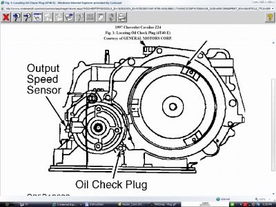

CZBONE
  • 20 POSTS
I have a Cavalier Z24, 2.4 engine with the 4T40E transaxle setup. It's an automatic transmission, but has no dipstick. The only thing it has is a red plastic screw-in cap labeled Trans Fluid neat the bellhousing.
I wanted to check the fluid level and wondered if there was any simple way of doing so? Thanks.

You have the 4T40-E tranny, no stick, run engine 5 mins, or to normal operating temp, leave engine runnung, Shift thru all gears, for 3 seconds each gear, leave in park and raise car on lift, unscrew the plug, fluid should drip out...if not add till fluid drips out.
https://images.2carpros.com/forum/automotive_pictures/62217_Plug_1.jpg
https://images.2carpros.com/forum/automotive_pictures/62217_Plug1_1.jpg

If your vehicle is equipped with the 2.4L engine, then it has the 4t40 tranny and there is no dipstick to check the fluid with. There is just a bolt in the side of the tranny. You must pull the bolt out and add fluid until it comes out the small hole on the side of the tranny. If the old fluid is burnt smelling or has metal shavings in it then it needs changed.
