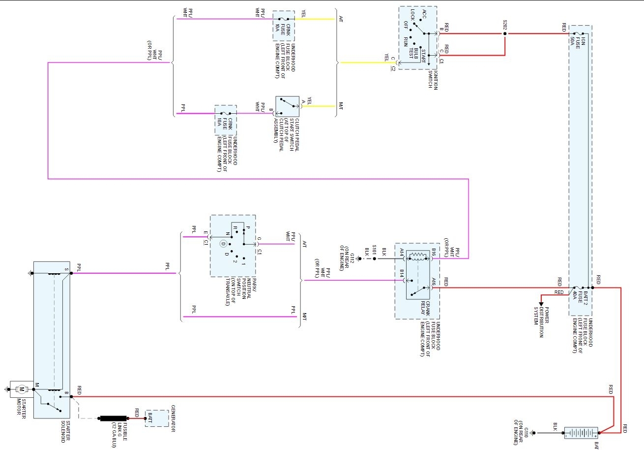

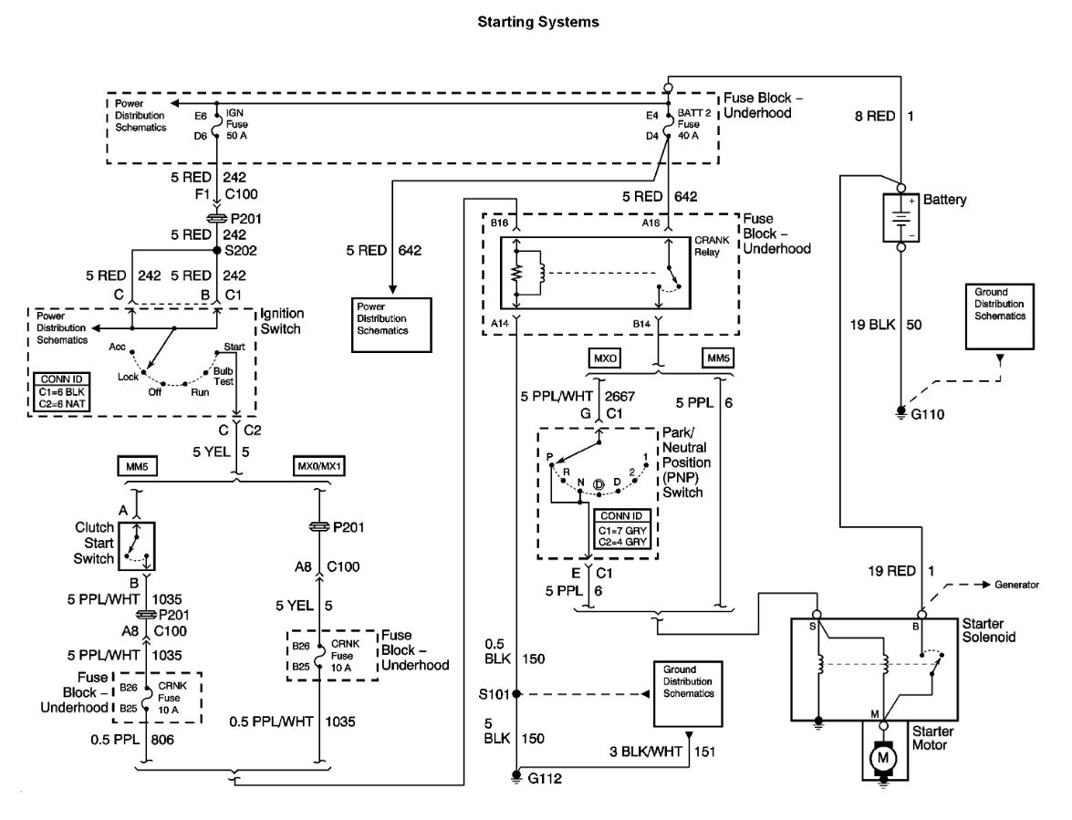

That makes it a lot of fun as they have a bad habit of tossing them in and then when you have problems you get to sort out what they really did. I've seen them installed where the wires were just twisted together, no solder no crimps, just twisted and tape. Others were oddball units that were the cheapest for that time and were the 99 dollar Christmas gift of choice. If you can find the make and model of the unit you could look that up and see what the install is supposed to be and use the wiring diagram to help sort it out. Some hook into the starter, door locks, lights, horn, and even the fuel system or ignition. My general policy on them is to remove them and return things to stock, then you at least have a base to start from. Let us know if you need anything else like the cars wiring diagrams or if you can find it the make and model of the system you have. I like to collect them and add the wiring and install info onto my shop machine if I can, that way if I run into that unit I already have an idea of what it is and does. Here are the diagrams for the starting side at least.

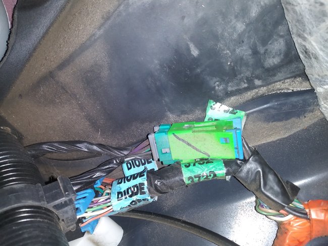

Hi Steve. I disconnected the alarm. Cut the wires to inside firewall. Just by chance and for no reason, I separated female/male connector. Noticed one connector had over heated melting plastic. I cleaned both parts. Put together, car starts and of course no alarm without horn present. Am I done or do I need to still find brain of aftermarket anti theft and disconnect?

I would still find it and be sure what is and isn't connected. Don't want to be out in the middle of a storm and have a loose wire or some odd thing happen because the module suddenly decides to short out. As for the melted connection, was it the large block connector? If so those cause issues like that when they melt.

Also, attached is picture of connector that had single wire melt down in it. This connector located in lower left front corner below dash. Close to floor in proximity.
