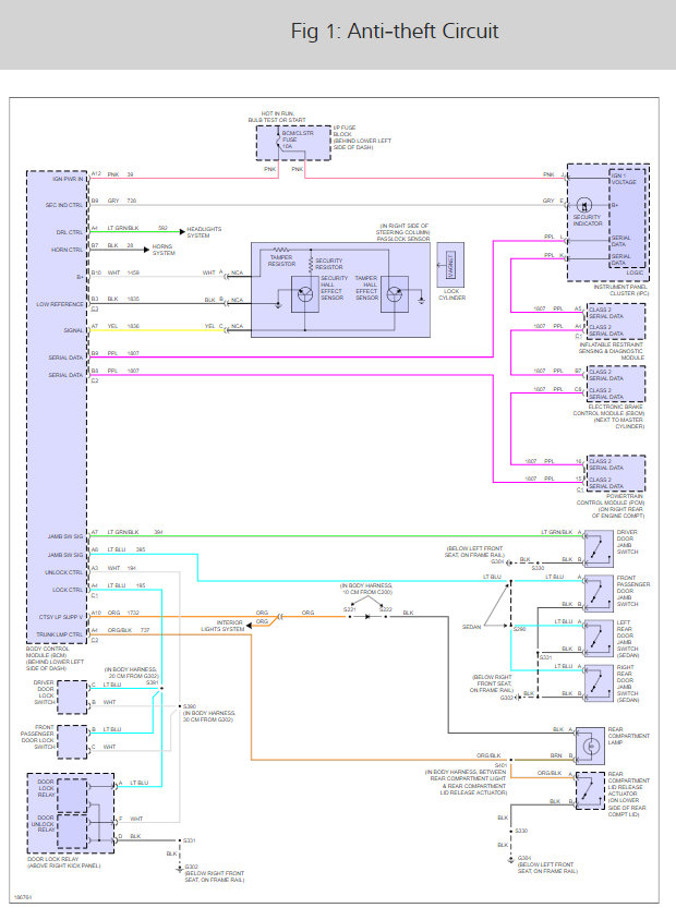

the anti theft system on my cavalier at odd times wont let my car start then for no apparent reason it will start, only warning is dash warning light for it comes on when trying to start the vehicle and stays on during cranking, anyway this system can be reset?
Sep 8, 2010 at 4:31 AM
  • 55,423 POSTS
Hey JROLEMAN,
This system cannot be bypassed. The #1 reason for a security problem is the drivers door latch. What happens is the switch inside wears out causing the alarm to think the car is being stolen. Replace it with a new one and the problem should be fixed.
Here are some guides on how to check it.
https://www.2carpros.com/articles/how-to-reset-a-security-system
and
Also there are two small wires up by the ignition switch that break causing the alarm not to reset.
Please let me know what happens so it will help others.
Best, Ken

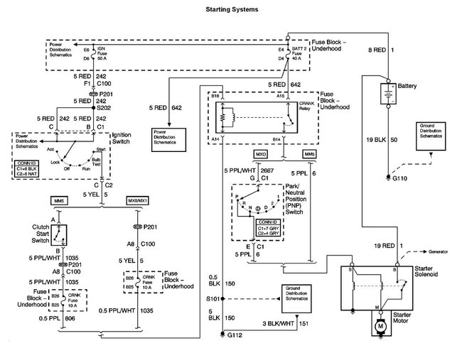

The battery was allowed to go low. Charged battery. When i recoonect batter anti theft goes off and wont try to start.
Jul 1, 2021 at 3:19 AM (Merged)
STEVE W.
  • 15,345 POSTS
Do you have a crank but no start or it doesn't turn over at all? Is the antitheft light on solid or flashing? I ask because the low battery on that car shouldn't trigger the anti-theft.

STEVE W.
  • 15,345 POSTS
With no anti-theft and no crank it's not the anti-theft system. On that GM the anti-theft turns off the fuel pump and will let the engine turn over and start but it would run for about 2 seconds the shut off. From then it would still crank but won't run. In this case I suspect that one of the battery cables is corroded and the power isn't getting through. When you turn on the lights do they come on? When you try to start it do you get a click or nothing? I would start by having the battery tested, if they go dead for long they can short internally and will not provide power enough to start the car. Many parts stores will do that for you for free. Then I would check the cables over for corrosion, The GM side terminal batteries tend to seep acid that goes into the cable connector and eats the internal metal until they stop working, but because it's all under the insulation you cannot easily see it without digging into it.
https://www.2carpros.com/articles/symptoms-of-a-bad-car-battery

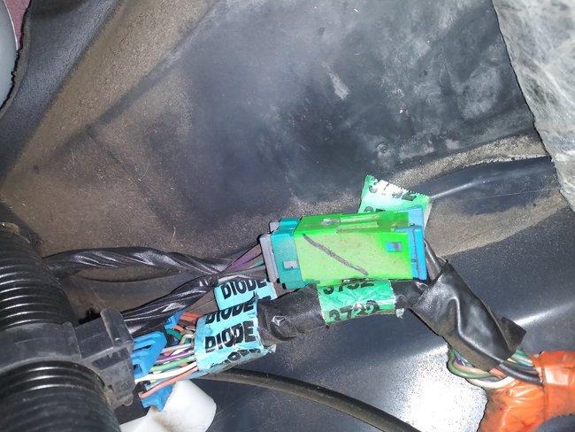

I believe the anti theft system was added because of the custom radio installed. I'm having trouble finding the "brain" of system location. Ideas where to look?
LEONARD JERRY NAGENGAST
  • 11 POSTS
Also, attached is picture of connector that had single wire melt down in it. This connector located in lower left front corner below dash. close to floor in proximity.
STEVE W.
  • 15,345 POSTS
Depending on the system they used it could be almost anywhere, the common locations are up under the drivers side dash or some were under the hood. Really depends on the installers desire. However if it's running OK it's not a huge priority. If it acts up then dig it out. Probably the easiest way to find it would be to pick a couple of the wires from say the ignition switch or power feeds and then trace them, look for any splices or connectors to different colored wires and follow them. For that vintage the control box is likely about the size of a VHS tape, but if it's newer it could go down to a deck of cards sized box, usually they have one or two connectors on them.

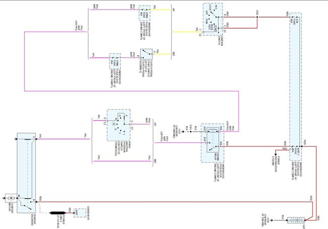

MICHELE BALTIERRA
Car will not start. checked pump with a battery it started to run then started car will jacked up with its battery still in it. it ran before the anti theft came on then car would not turn over until I did the battery thing to check the pump. how do I dis arm anti theft problem?
Jul 1, 2021 at 3:20 AM (Merged)
WRENCHTECH
  • 20,761 POSTS
You can try the relearn procedure.

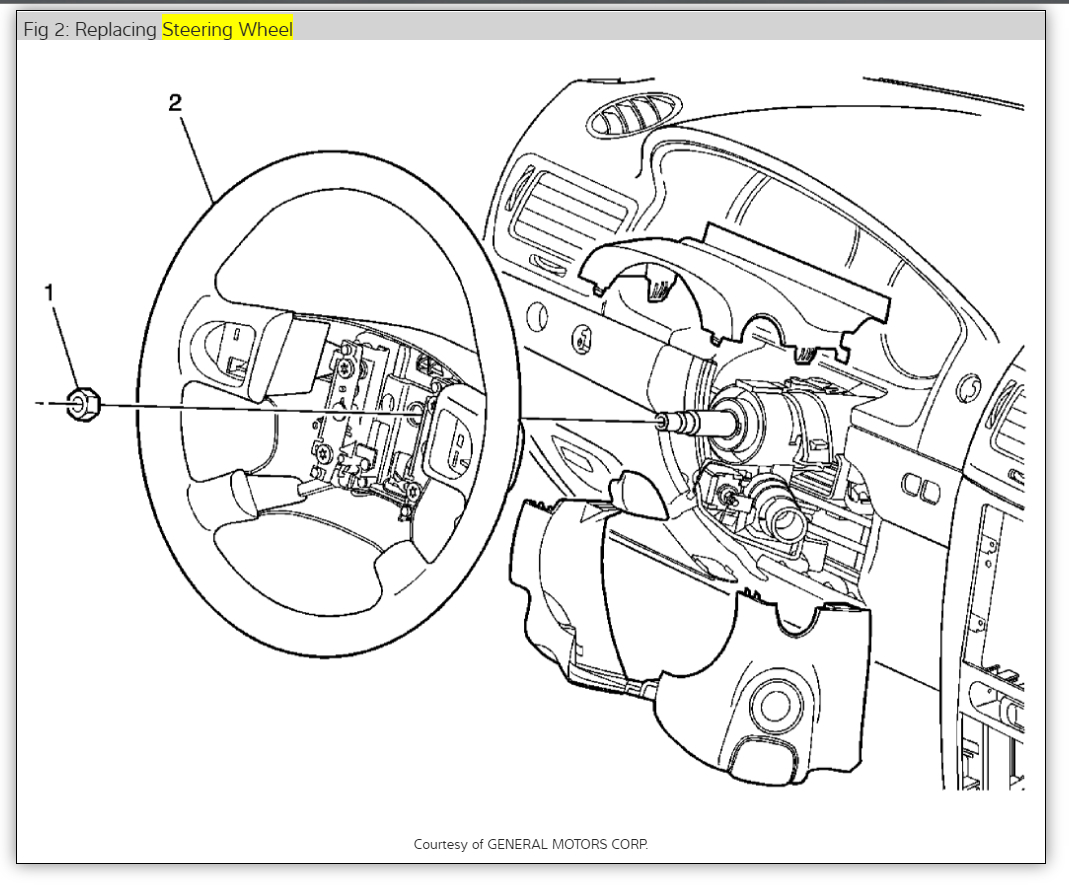

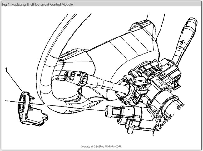

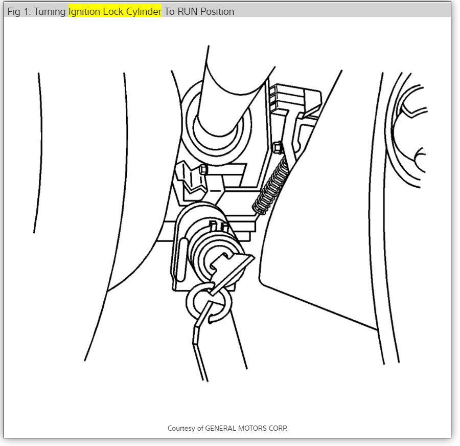

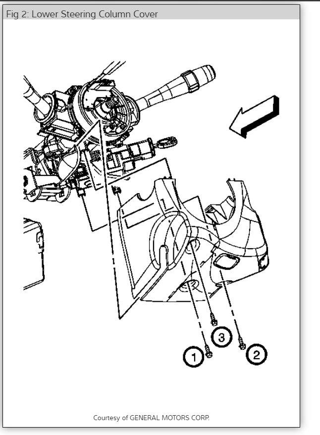

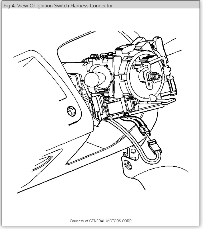

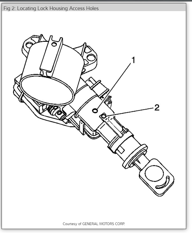

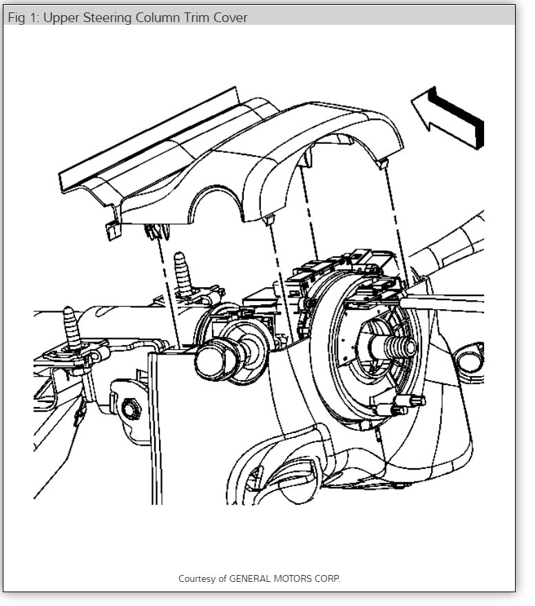

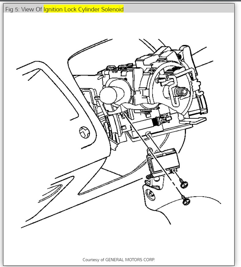

This article has been updated with bulletin, 01-02-35-010
Ignition Lock Cylinder Replacement -On Vehicle (With Key)
Removal Procedure
Caution: Refer to Battery Disconnect Caution in Service Precautions.
1. Disconnect the negative battery cable.
Caution: Refer to SIR Caution in Service Precautions.
2. Disable the Supplemental Inflatable Restraint (SIR) system.
3. Remove the steering column trim covers.
4. Turn the ignition lock cylinder (1) to the RUN position.
5. Push the locking button (2) on the rear of the housing assembly (1).
6. Remove the ignition lock cylinder by pulling outward from the steering column.
7. Disconnect the electrical connector (3) from the ignition lock cylinder (1).
Installation Procedure
1. Connect the electrical connector (3) to the ignition lock cylinder (1).
2. Insert the ignition lock cylinder into the housing assembly (1) while rotating the key approximately 5 degrees counter - clockwise.
3. Install the steering column trim covers.
4. Enable the SIR system.
5. Connect the negative battery cable.
6. Perform the Passlock Learn Procedure.
IMPORTANT: Due to component variability, the vehicle theft deterrent (VTD) system must have the learn procedure performed regardless, even if the vehicle starts on the first ignition cycle after a VTD repair. All codes in the theft deterrent module must be cleared for a relearn.
If you replace the ignition lock cylinder, the system will enter the long tamper mode. If the system enters the long tamper mode, ensure that the system completes a long tamper mode cycle. During the long tamper mode cycle, the THEFT indicator will flash for the full 10 minutes. The instrument cluster and the PCM require the full 10 minutes in order to complete the learn cycle. Ensure that the ignition switch remains in RUN until the indicator stops flashing. If you turn the ignition switch before the indicator stops flashing, ensure that you repeat the long tamper cycle from the beginning.
