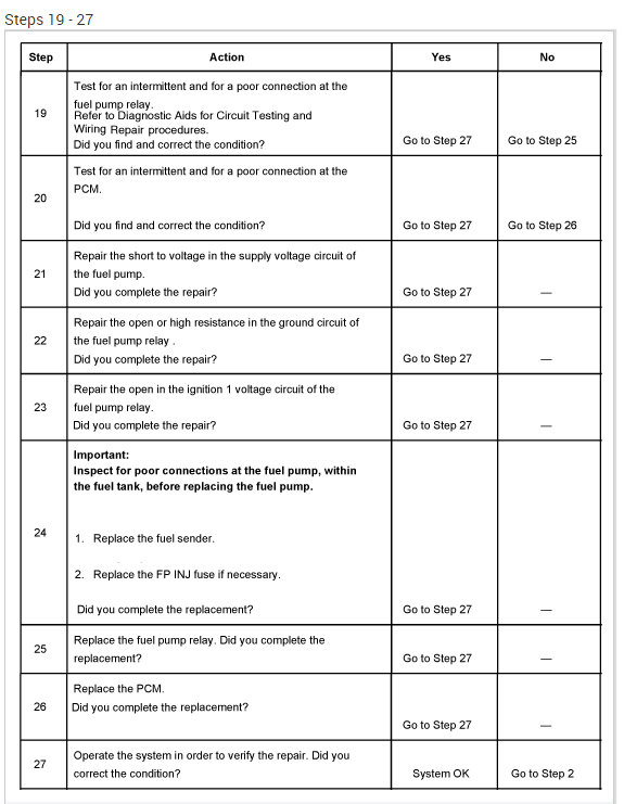

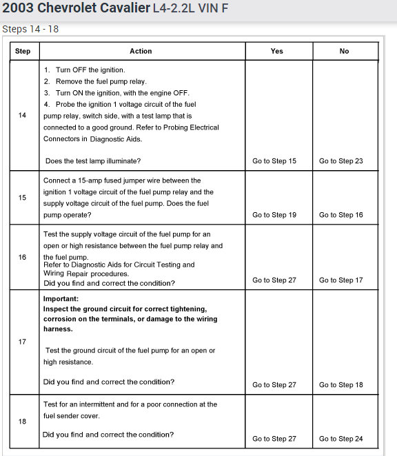

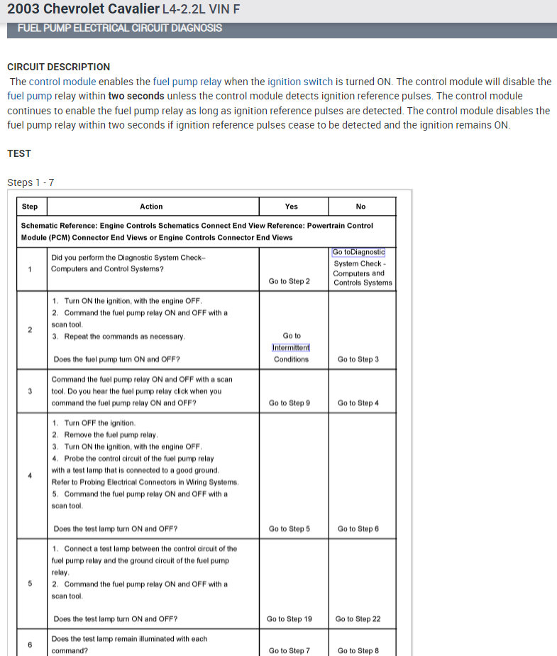

won't start i am not getting enough fuel to start it i have changed the fuel filter and the pressure regulator and still nothing. i dump gas into the throttle body and it starts and runs till it runs out of gas but i hear the fuel pump kick on and run what should i do

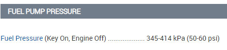

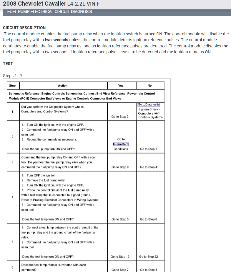

Have you tested to see if the pump is producing correct amount of fuel pressure?
Should be between 50-60 PSI with key on, engine off.

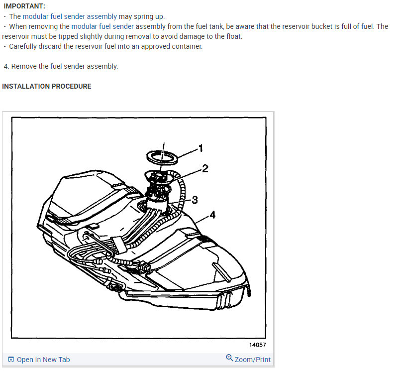

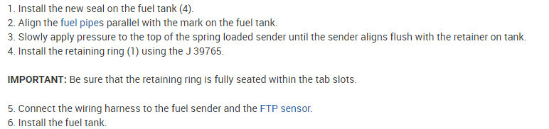

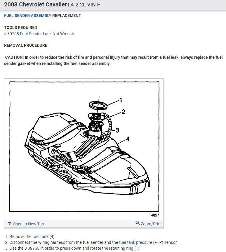

You might find this articles helpful:
https://www.2carpros.com/articles/how-to-replace-an-electric-fuel-pump
Here is a video of replacement procedure:
https://youtu.be/Lhd0vd8pdBU

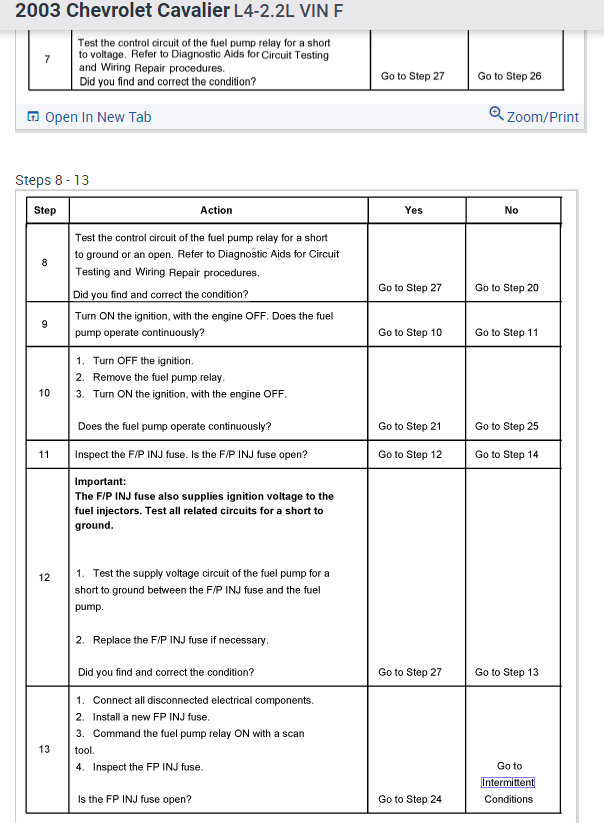

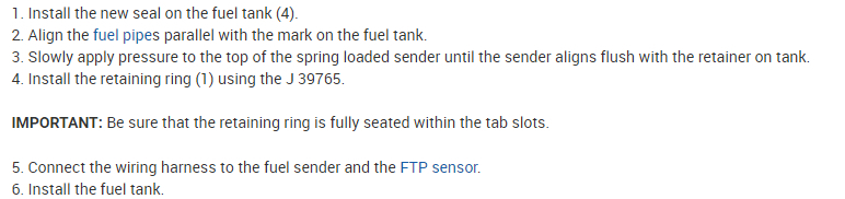

I have attached test procedure for the pump and replacement.
Any questions please let me know.
