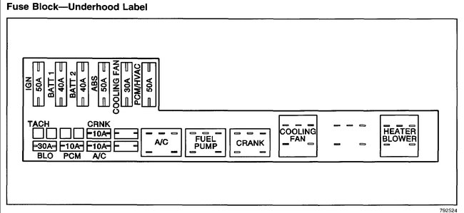

Have you tested relays and checked fuses first?
Here are two guides and a video to help us see whats going on.
https://youtu.be/Lhd0vd8pdBU
and
https://youtu.be/S6ka-fscAuw
and
You can remove the relay and take it to any auto parts store i.e Napa, Autozone, Advanced auto parts, to test the relay for you. Or touch the relay with it plugged into the connector and have someone turn your car on (not crank it) you should feel the relay click. If it doesn't click, then the relay is not coming on. Check power to relay. There is one wire that should be consistently hot, usually an orange or red color. If you unplug the relay and use a multimeter to check the terminals on the relay connector, there should be one terminal that gets voltage with the car off. If power is getting to relay but relay is not clicking, replace relay.
If still need to test fuel pump wiring, check voltage of the GREY wire.

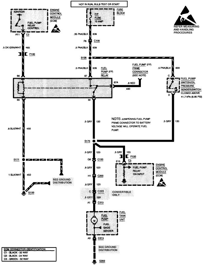

  • 16,098 POSTS

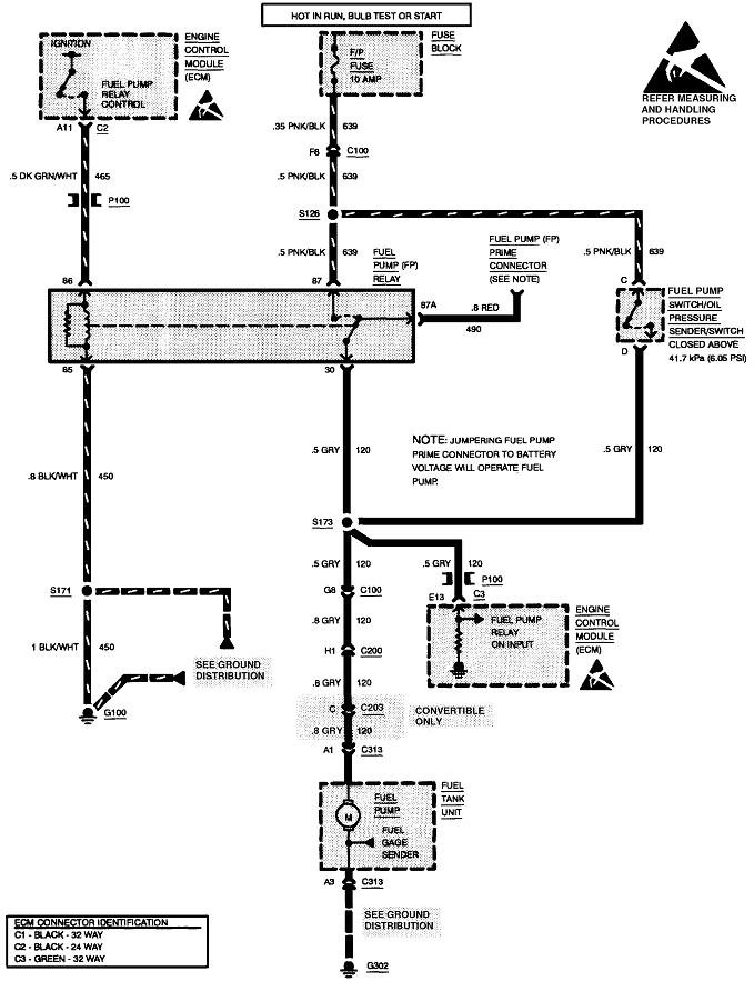

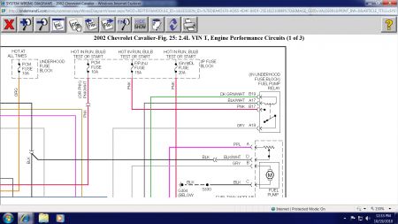

Hello, the gray wire at the pump relay, carries voltage to the pump, should be hot with the engine cranking. Pink wire comes from fuse, should go hot when you turn on the key. The dark green wire with white tracer is voltage signal from the pcm to the coil side of relay, should be hot, with engine cranking.
Are there any codes? I just wanted to add, you can do some testing at the fuel pump relay in the power distribution center under the hood. The relay may have a wiring diagram on it. If one symbol looks like an open switch, one terminal is for the pink wire, the other gray. The symbol for the other side of relay, looks like a small coil, one of those terminals is for the dark green wire with white tracer. You can unplug the relay, have a helper crank it, use a testlite on the terminals for the pink and dark green with white tracer. Also make sure the relay is good.
Read the guide below on relay testing
The wiring diagram for the fuel pump circuit is attached below

I'd use a gage and check fuel pressure, engine cranking. Also, unplug the fuel pump relay, use a digital multimeter where the relay plugs in, two circuits should be hot, engine cranking. Are they? The fuel pump fuse goes hot with the key on, check for voltage. A missing rpm signal could cause a problem, that would cause other issues, like no injector pulse. Could be wiring circuit problem somewhere. Can you check for codes?
https://images.2carpros.com/forum/automotive_pictures/170934_fuel_pump_relay_2.jpg

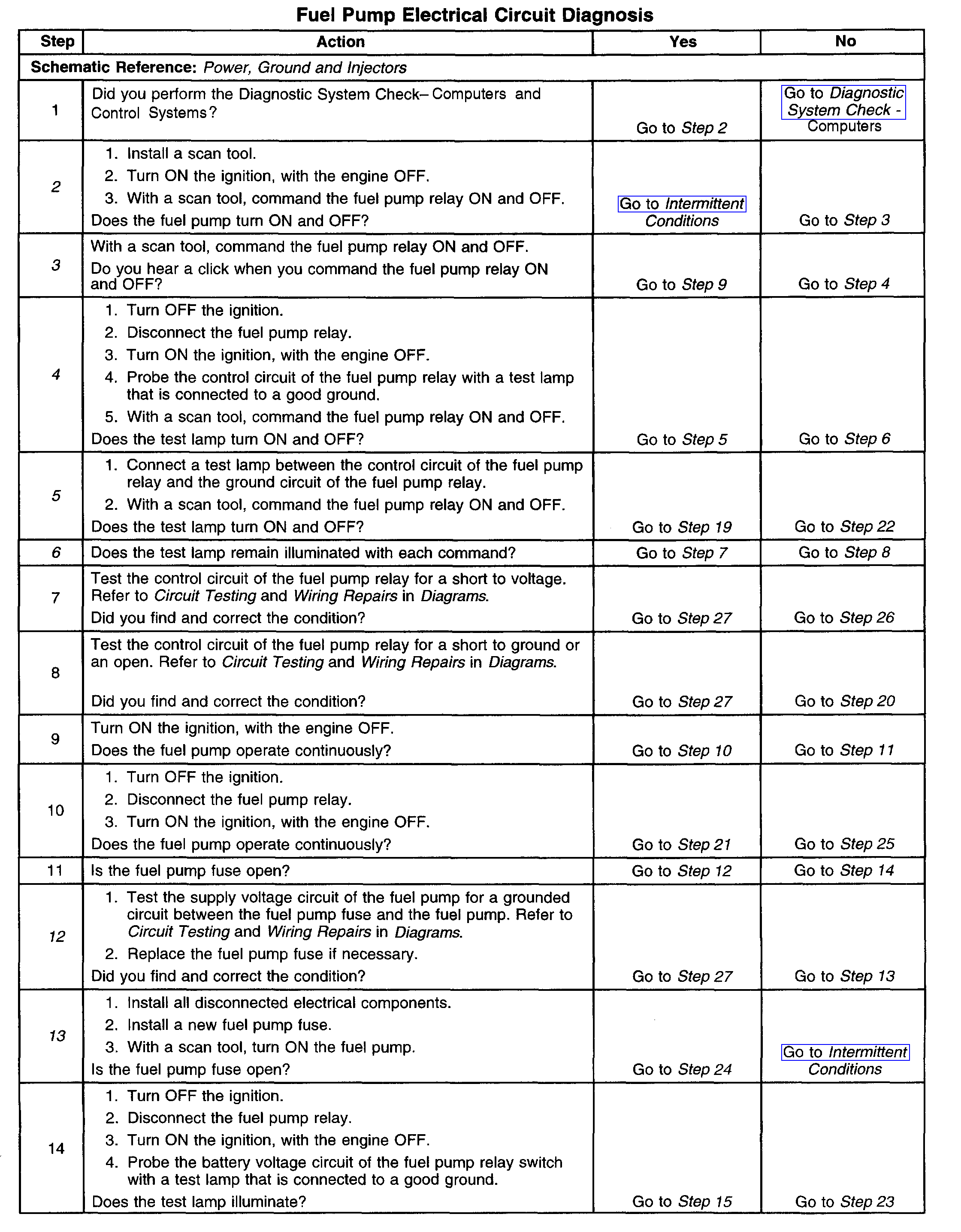

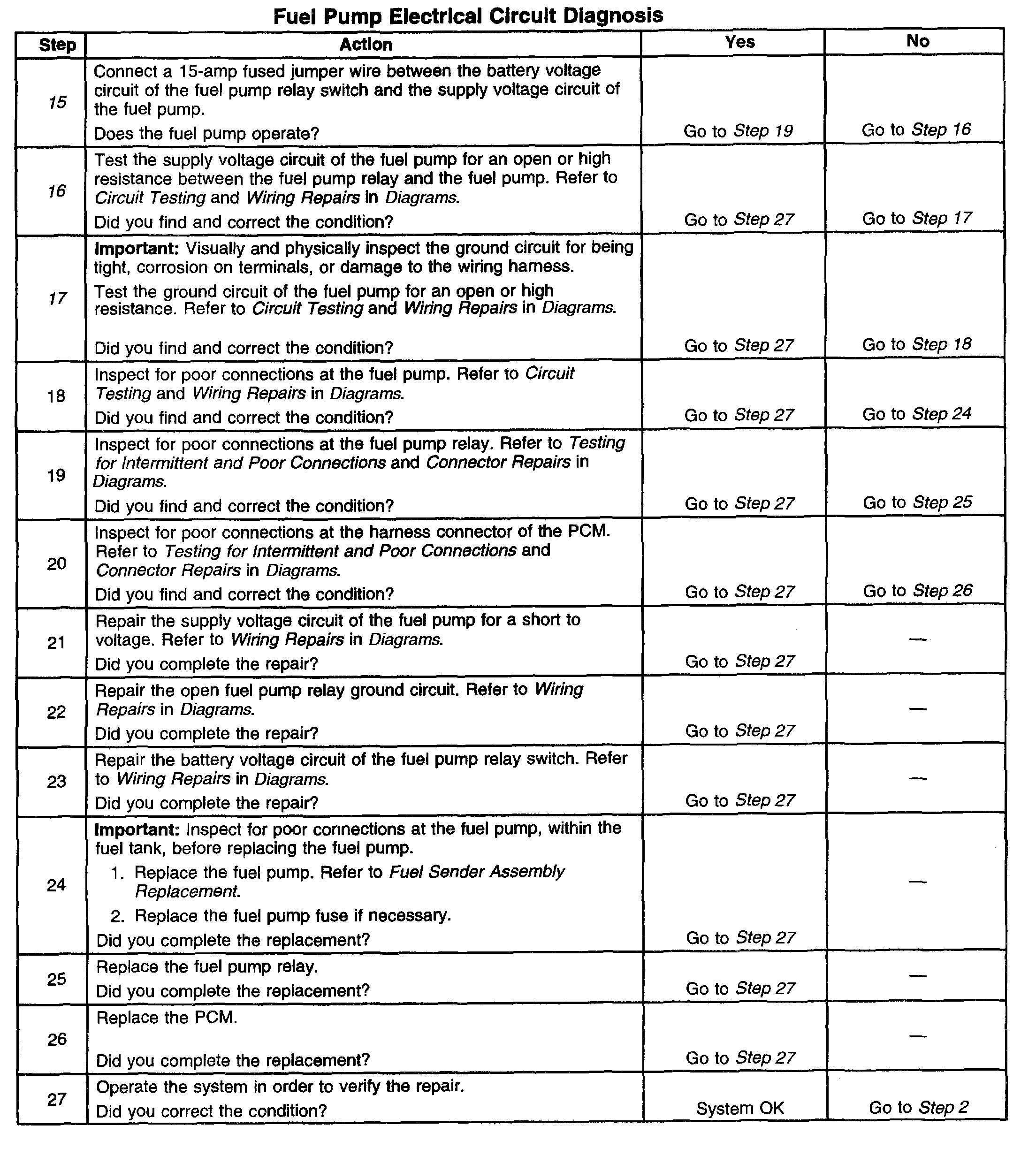

As far as the pump not turning on, have you checked for power at the pump itself? There could be a couple of reasons it doesn't turn on. Do me a favor. Here are the diagnostics for checking the electrical circuit for the pump. Take a look through it and let me know if it helps. The attached pics are the actual flow charts.
Check out the diagrams (Below).
The Powertrain Control Module (PCM) will turn ON the in-tank fuel pump, with the ignition ON. The in-tank fuel pump will remain ON as long as the engine is cranking or running, and the PCM is receiving ignition reference pulses. If the PCM does not detect any ignition reference pulses, the PCM turns the fuel pump OFF 2 seconds after the ignition is turned ON.
The in-tank fuel pump is an electric pump that is attached to the fuel sender assembly. The fuel pump is designed to provide fuel at a pressure above the pressure that is needed by the fuel injectors. A fuel pressure regulator, which is attached to the fuel rail, keeps the fuel available to the fuel injectors at a regulated pressure. Unused fuel is returned to the fuel tank by a separate fuel return pipe.
TEST DESCRIPTION
The numbers below refer to the step numbers on the diagnostic table.
2. Command both the ON and OFF states. Repeat the commands as necessary.
3. This step determines if the condition is located on the coil side or the switch side of the circuit.
4. This step verifies that the PCM is providing voltage to the fuel pump relay.
5. This step tests for an open in the ground circuit to the fuel pump relay.
6. This step determines if a voltage is constantly being applied to the fuel pump relay.
12. To gain access to the fuel pump connector, the fuel tank may need to be removed.
13. This step determines if the condition with the circuit is intermittent. If the fuse does not open, inspect the supply voltage circuit between the fuse and the fuel pump for an intermittent condition.
15. Use the same amperage fuse in the jumper as is used to protect the fuel pump circuit.
16. To gain access to the fuel pump connector, the fuel tank may need to be removed.
17. Inspect the splice pack which contains the fuel pump ground and other ground circuits. Be certain all connections within the splice pack are clean and tight.

  • 55,433 POSTS
Your car is not equipped with an inertia switch like most Ford cars. There is a fuel pump relay through that goes out which will cause the same problems.
Here is a guide and the fuel pump control relay so yo can confirm and fix the problem.
You should check the fuse as well
(Check out the diagrams below)

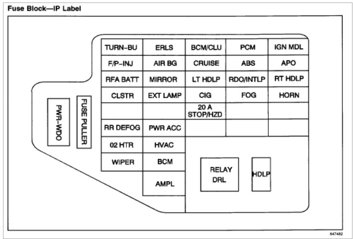

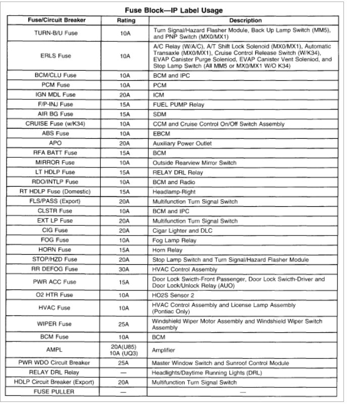

If your checking for power at the pump, you have to do it during the first 2 seconds of "key on". It shuts off after that until it sees a tach signal.
Also check the F/P-INJ fuse (20amp)

  • 75,992 POSTS

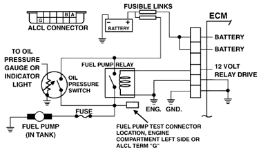

The power should come from the fuel pump fuse if the relay and the computer driver is working when key at run position
https://images.2carpros.com/forum/automotive_pictures/12900_oil_sending_unit_and_fuel_pump_circuit_67.gif

  • 34,383 POSTS
There should be 0 volts at the fuel pump unless you're cranking the engine. The pump must not be running when the engine isn't running. That's a safety system on all cars. Your fuel pump relay is turned on by the Engine Computer and by a separate switch built into the oil pressure sensor. The circuit is also monitored by the Engine Computer.
I have a suspicion you're using a digital voltmeter to measure the voltage at the pump, with the connector unplugged. The 8 volts you're finding would be coming out of the computer on its sensing circuit, and would normally be grounded out by the pump when the pump is plugged in. For this type of problem, voltage readings are only valid when everything is plugged in and connected. You have to back-probe through a connector to take the readings.
As an alternative, a test light is more accurate for this type of problem than a voltmeter. The old-style test light uses a light bulb that will load the circuit down just as the pump motor would, and will likely make that 8 volts disappear. Then, the 0 or real low voltage you see is accurate and is what you really have.
What you should find now is the Engine Computer turns the fuel pump relay on for one second when you turn on the ignition switch, then it will go back to 0 volts. That voltage should go back to 12 volts when you start cranking the engine, and / or when oil pressure comes up. The switch in the oil pressure sending unit will keep the pump relay turned on even if the computer's circuit turns off. That way, if a fuel line is ruptured in a crash, the engine will stall, oil pressure will go to 0 psi, and that will turn off the fuel pump relay so raw gas doesn't get dumped on the ground where it would be a fire hazard.
A common failure is the switch in the oil pressure sending unit, but then, you still should have close to normal fuel pressure from that one second the pump runs when you turn on the ignition switch. That should be enough for the engine to run for a couple of seconds. You should also be able to hear the hum of the pump for that one second. If you don't hear that, use a fuel pressure gauge to check the fuel pressure. If it is at 0 psi and never budges from that, the fuel pump has likely failed. If you see fuel pressure start to come up a little when you turn on the ignition switch, then it goes right back down to 0 psi, suspect a leaking injector that is bleeding off the pressure. That will take a couple of seconds at least to bleed all the way down to 0 psi.
Don't overlook checking for spark. If you have good fuel pressure during cranking, but spark is missing, you likely don't have injector pulses either. Then the crankshaft position sensor would become the better suspect. It's the signal pulses it develops that tells the Engine Computer when the engine is rotating. Those pulses are also used to trigger the injectors and ignition coils at the right time.
