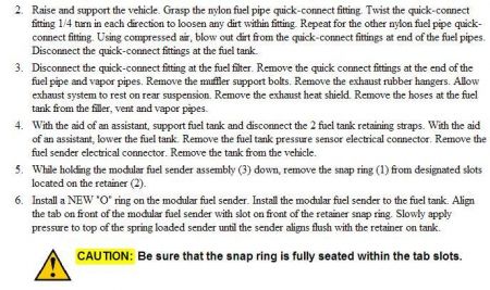

Is it dificult to replace electric in tank fuel pump.

If you do not have experience with vehicle repairs like this than I suggest leaving it to a shop to prevent possible injury to self or damage to vehicle.
http://www.2carpros.com/forum/automotive_pictures/261618_Noname_911.jpg
http://www.2carpros.com/forum/automotive_pictures/261618_Noname2_243.jpg
http://www.2carpros.com/forum/automotive_pictures/261618_Noname3_87.jpg

Its not too hard, the most difficult part is dropping the tank harder if it is full.
