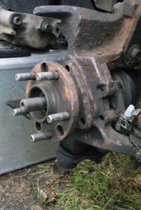

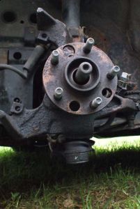

I've been working to change the bearings system on the front wheel conductor side. I removed all the bolts (3 bolts holding the bearings system), and I can't remove the bearings, it'ts like it been weld there in the rust!!!! I tried many things:
with a hammer, a crowbar . . . It dosen't move a millimetre!!!!!
What can I do??????????

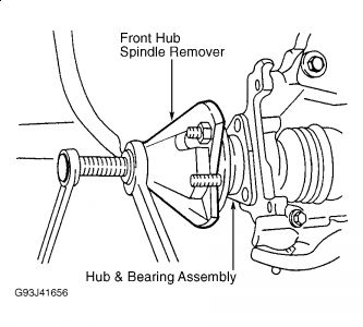

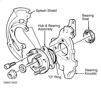

Hi Have you removed axle? see diagrams

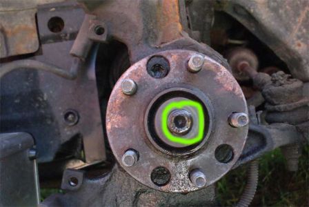

Do you mean the big Bolt in the center of the bearing Assembly? If it's that, yes! If not, how I remove the axle? Thanks

With the tool in figure. Is axle free in hub ie. can you push it back easily?
Sep 14, 2009 at 4:07 AM
MGPROD
Yes I can push it back easily.

Well you may need to remove spindle and press out bearing or get the tool to pull out bearing

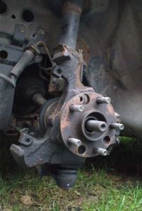

Can You point me the spindle in one of the 3 pictures that I sent you, and how to remove it?

DOCFIXIT
  • 18,828 POSTS
It is the heavy metal piece that hub/bearing is in. Need to remove ball joint, tie rod and strut. May want to see if a parts house has tool and will rent to you.
