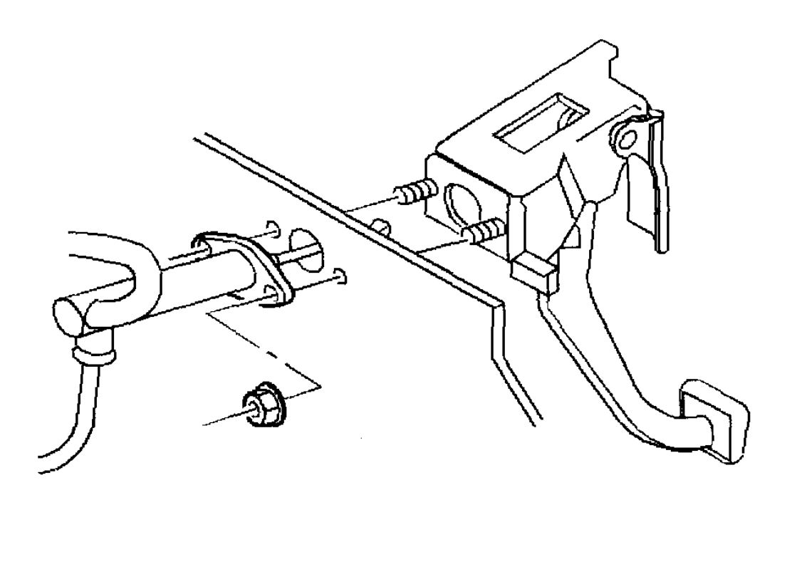

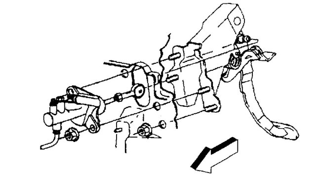

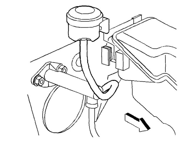

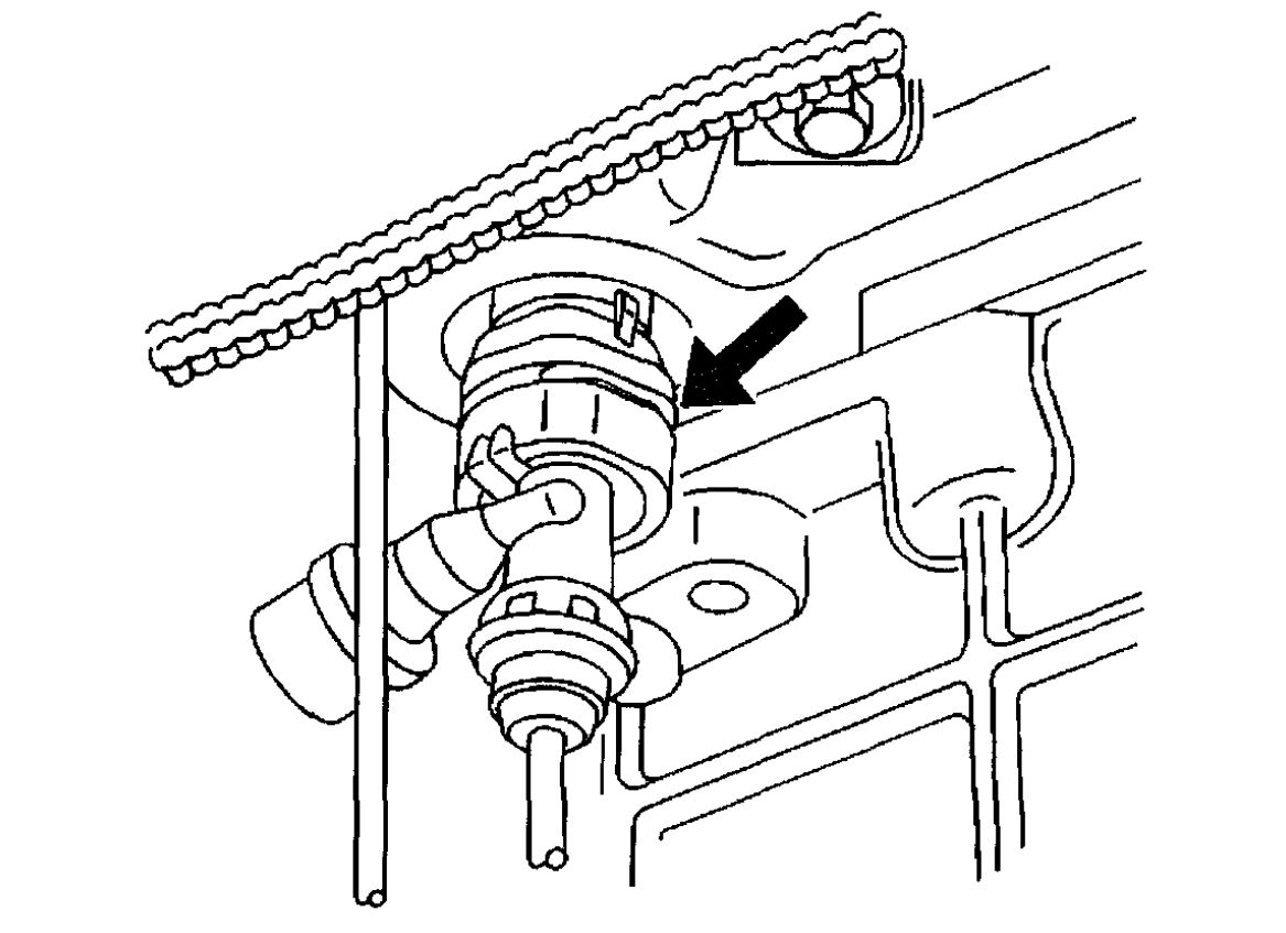

My clutch is not working and it seems to be a different problem than everyone else is having. I have bled the clutch many times and it works for about 5 minutes and then it gets air in the system and the pedal sticks to the floor the thing that is confusing me is that it doesn't lose fluid the only time the fluid goes down is when I bleed the system so it is just sucking air and not leaking fluid I don't know what would cause this because I am not real familiar with hydraulic clutch systems like these so any information would be appreciated thank you for your time

Sounds like the clutch master cylinder is leaking internally if there's no external leak. I would do the clutch slave and master as a set

Removal Procedure
1. Remove the clutch master cylinder push rod from the clutch pedal.
2. Remove the master cylinder retaining nuts at the front of the dash.
3. Remove the remote reservoir.
4. Disconnect the clutch actuator cylinder line.
5. Remove the clutch master cylinder assembly from the clutch pedal assembly.
Installation Procedure
1. Install the clutch master cylinder assembly to the clutch pedal assembly.
2. Connect the clutch actuator cylinder line.
3. Install the remote reservoir.
4. Install the master cylinder retaining nuts at the front of the dash.
Tighten the nuts evenly to 21 Nm (15 ft. lbs.).
5. Install the push rod to the clutch pedal.
6. Bleed the hydraulic system.
Hydraulic Clutch Bleeding
Notice: Do not reuse the fluid that has been bled from a system in order to fill the clutch master cylinder reservoir for the following reasons:
1. The fluid may be aerated
2. The fluid may be contaminated
3. The fluid may contain too much moisture
Important: Maintain the fluid level in the clutch reservoir to the top step with GM P/N 12345347, or equivalent.
1. Clean dirt and grease from the cap in order to ensure that no foreign substances enter the system.
2. Attach a hose to the bleeder screw on the clutch actuator assembly. Submerge the other end of the hose in a container of Hydraulic Clutch Fluid GM P/N 12345347, or equivalent.
3. Depress the clutch pedal slowly and hold.
4. Loosen the bleeder screw to purge air.
Tighten the bleeder screw to 2 Nm (18 inch lbs.).
5. Repeat steps 3 through 5 until air is purged.
6. Fill reservoir to the top step with GM P/N 12345347, or equivalent.
7. Repeat the bleeding procedure if necessary.

Good chance the slave is leaking. The bleeder is on the slave down on the transaxel.
