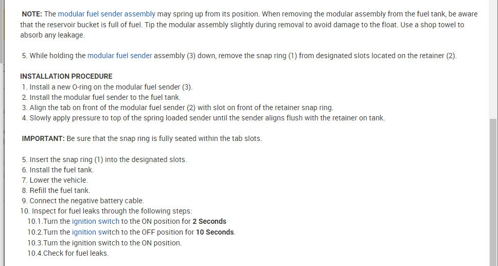

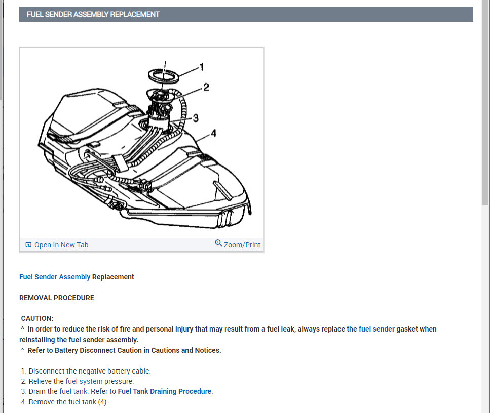

Car gets warm and then you hear a hum noise and the engine shuts off.
Thursday, April 24th, 2008 AT 1:50 PM
MECHANIC
18,907 POSTS
This is a fuel pump failing. We can confirm this by checking the pressure using this guide:
If the pressure is low or drops when this stalls then we are going to need to replace the pump using this guide to help:
https://www.2carpros.com/articles/how-to-replace-an-electric-fuel-pump
I am attaching the process below from the manual on how to replace this.
Please run through this material and let us know if you have other questions. Thanks
