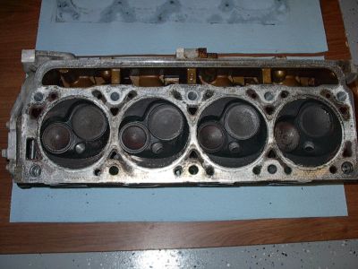

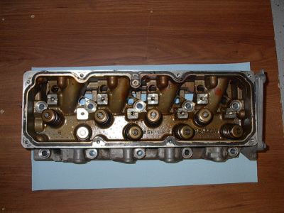

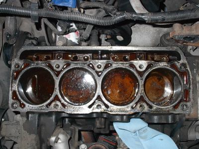

Okay. I got the Head and Head Gasket off this weekend and took some pics. I've posted some pics in this thread and I have put ALL of the pics (full size - 2 pages) here:
Obviously, coolant needs to be removed from each cylindar, again. I'm going to have the head tested by a machine shop as suggested before I install the new HG. I will be replacing the valve cover gasket and the gaskets for the intake and exhaust manifolds as well. I also need to clean the block surface.

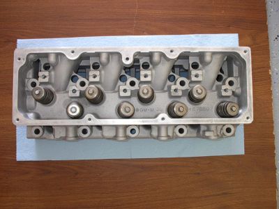

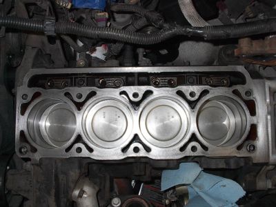

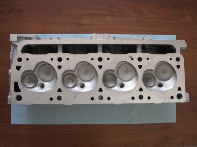

I got the head inspected by a machine shop. They recommended a pressure test, resurface, and a valve job. I agreed to the tune of $275. I cleaned up the block and cylinders myself. I replaced the head gasket and reassembled the engine. I then did a compression test (engine cold) and got 167 171 174 164. A huge improvement from before.
I went to start the car and the engine turned over beautifully but only ran for about 3 seconds and died. I will be posting about this in another thread. So the answer to this question is: YES, if the head gasket is blown enough it can restrict the engine from fully starting. Thank you.
