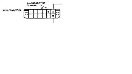

Hi, if the fuel pressure spec is good, why would the fuel pump relay be faulty? Some of the national brand autostore used to loan out a fuel pressure gage. With TBI, you should be able to see injector spray pattern? Is it spraying with the engine cranking? The spray pattern doesn't mean the pressure is good, it shows there is voltage and ground pulse for the injector. Check for trouble codes, you never know? You can check for codes by using a jumper wire between the A & B terminals at the datalink connector. Turn the key just till the dash lites come on, no further, then the mil starts flashing, you count the flashes to get the codes. Your looking for two digit codes.
