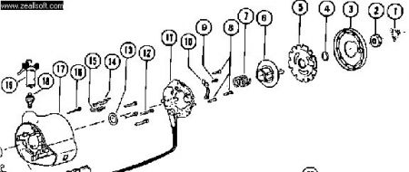

I have a 1989 Chevy Camaro with a 2.8 V6, manual transmission, with 140,000 miles. I've had to replace the steering column twice, (tilt) because something keeps breaking inside. (Flops around, won't lock in place). I think this might be a common problem because it is next to impossible to find one.I'm told this column fits this year only. Is there a column from another year or car that I can use and fit it for this car? As long as the wiring is the same or close, I can
mechanically get it to work. Please Help!!!!!!!!

is it broken or its loose u can fix it remove horn pad disconect electical then remove retainerand jam nut remove steering wheel remove shaft lock ring remove turn signal cam then upper spring unscrew turn signal and then gently pull wires up and work your way down
https://images.2carpros.com/forum/automotive_pictures/99387_camaro_3.jpg
after vremoving # 17 look inside round hole loose screws remove it lock tight on it and reinstall it long put it can be done good luck

Treat the tilt column as possibly loose rather than broken. Remove the horn pad, disconnect the electrical connectors, and remove the retainer, jam nut, steering wheel, shaft lock ring, turn signal cam, and upper spring. Unscrew the turn signal switch and gently pull the wires up. After removing the indicated part, inspect the round hole for loose screws, remove them, apply thread locker, and reinstall them.
