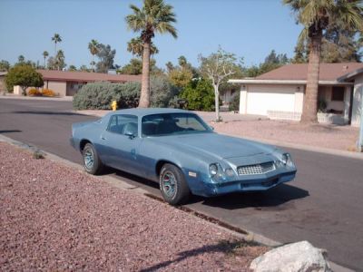

1981 Chevy Camaro V8 Two Wheel Drive Automatic 7XXXXX miles
Ok to start off my starter went dead so i replaced it then we replaced the starter solenoid but after doing all that the car wont start and just makes a clink sound the radio works the lights work but the car only makes a clink sound when trying to start it wont start.
http://www.2carpros.com/forum/automotive_pictures/225676_l_fb16e4c6b3ceda36addb1782fb56c02e_1.jpg

Double check the battery and its connection-if okay could be the ignition switch and neutral safety switch.
Hold key in cranking position-look for power at the purple wire on the starter solenoid. Do you have it?
