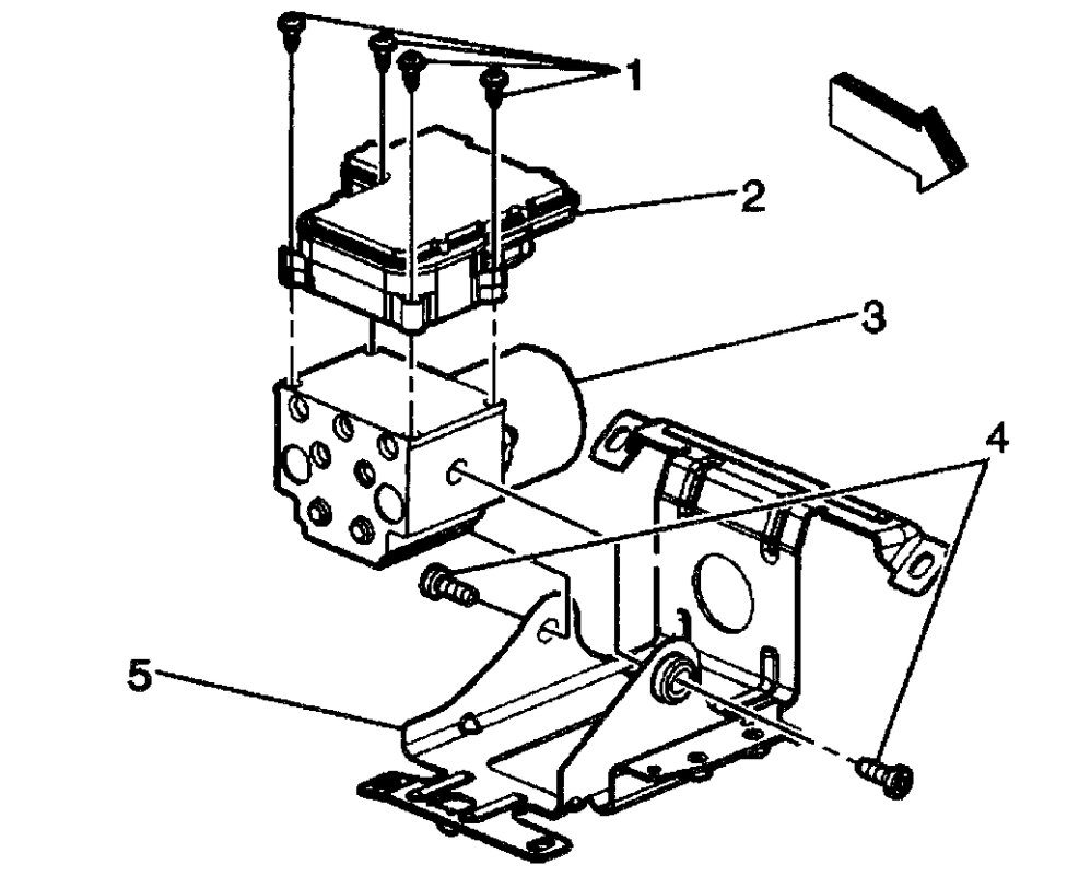

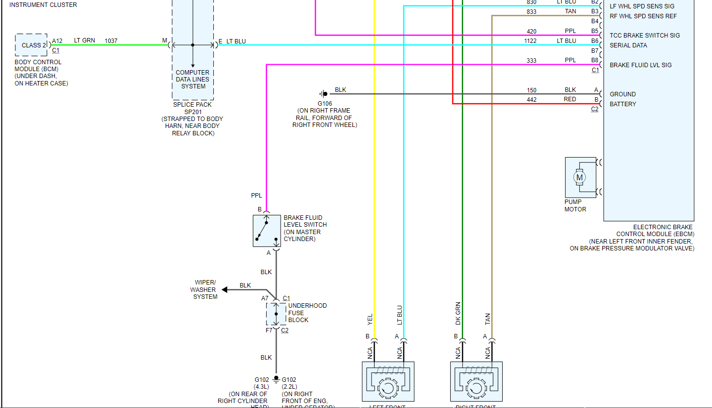

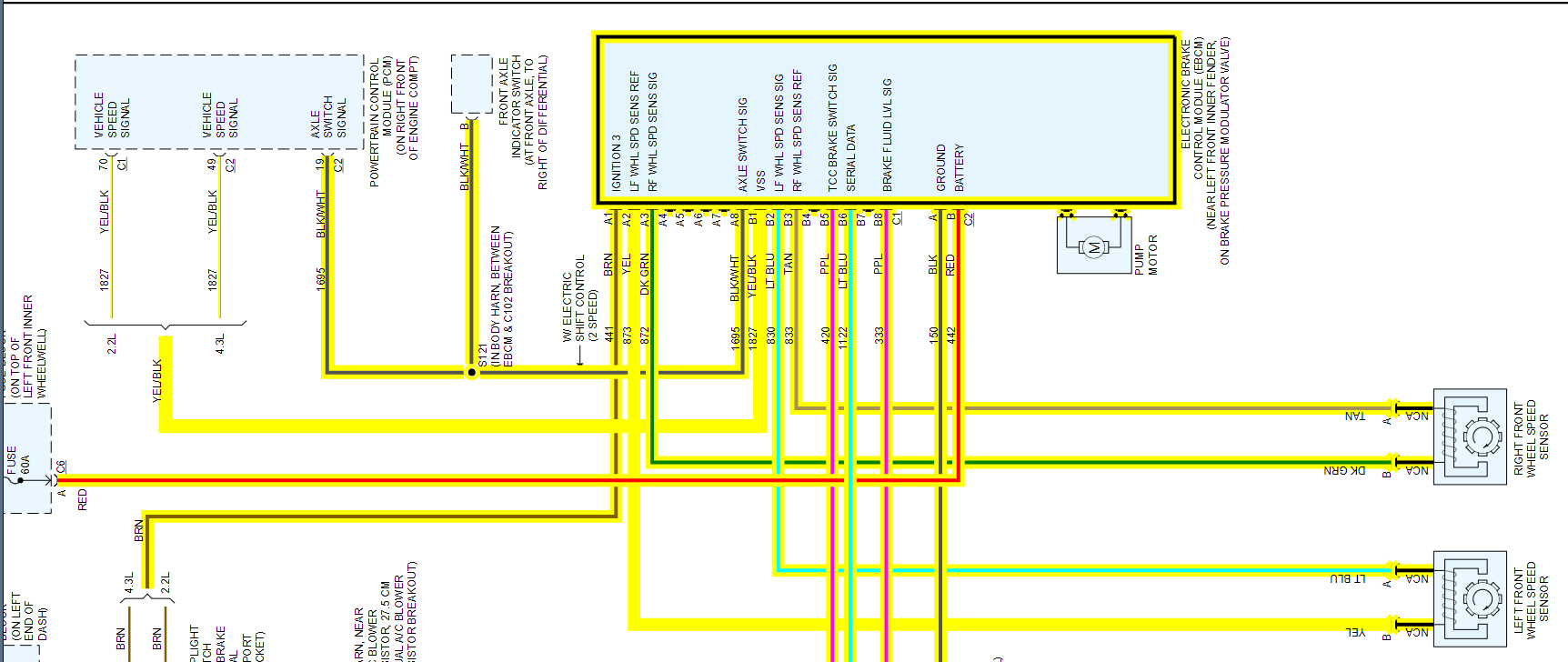

I purchased this blazer with the ABS module out, I need to replace it can you help me please?

I attached the procedure for you for the module. I also attached the wiring diagram of the system for you and specifically the module connector. This video shows the job being done on a similar car but the process is the same.

Electronic Brake Control Module (EBCM) Replacement
Removal Procedure
Important: After installation, calibrate the new EBCM to the tire size that is appropriate to the vehicle.
Important: Thoroughly wash all contaminants from around the EHCU. The area around the EHCU must be free from loose dirt to prevent contamination of disassembled ABS components.
1. Disconnect the electrical connectors from the EBCM (2).
2. Remove the four T 25-TORX mounting screws (1) that fasten the EBCM (2) to the BPMV (3).
3. Remove the EBCM (2) from the BPMV (3). Removal may require a light amount of force.
Important: Do not use a tool to pry the E13CM or the BPMV.
4. Clean the BPMV (3) to EBCM (2) mounting surfaces with a clean cloth.
