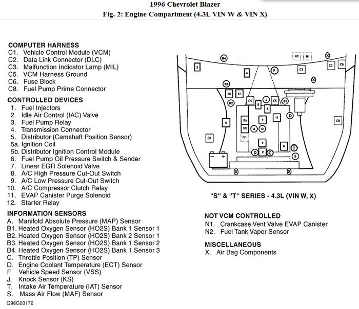

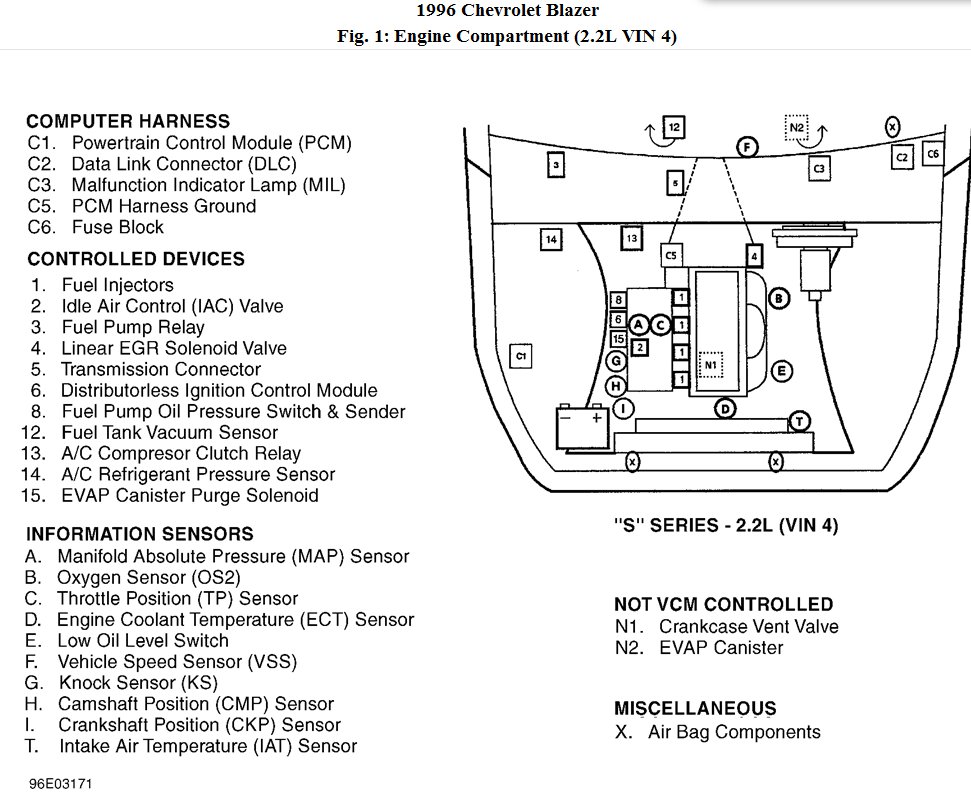

Please help my 4x4 full size chevy blower fan was going on and off and now has stoped working, where do I locate the fuse and or what other things should I be cheaking
Monday, December 28th, 2020 AT 11:09 AM (Merged)
DRCRANKNWRENCH
  • 3,380 POSTS
The ralay might be bad as well. If you check the fuse and it is good, the relay may need to be replaced. It is located at the center rear of the engine compartment.
The fuse box is located on the leaft side of the dash. The cover should have a diagram on it mapping out the location with a description of the fuses in the panel. It is somethimes hard to orient this diagram, so make sure you have it right by using the spare fuses or large relays as landmarks to orient the diagram in relation the the fuse location.
I am giving you 2 diagrams. They are electrical component location diagrams and show the fuse panel, but I did not see the relay represented. One is for a 2.2L and the othe is for the 3L.
They are labeld at the top when you click on them you will be able to see this.
They both have the fuse panel in the same place, but I figured you might be able to use them for other purposes or just to have them.
If you need anything else, please don't hesitate and I will reply ASAP.

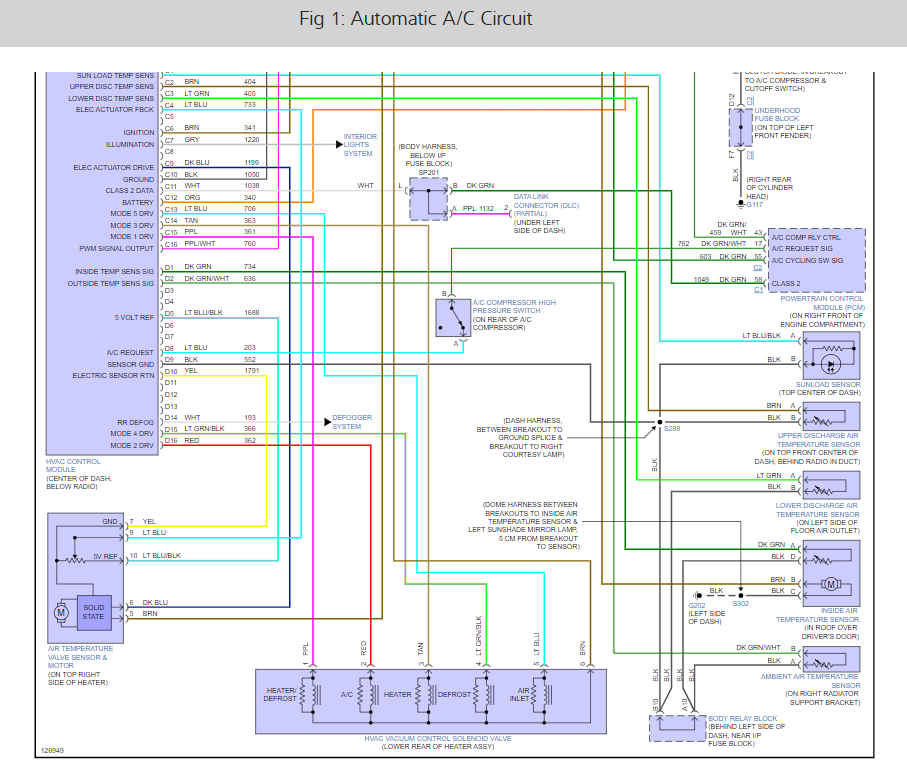

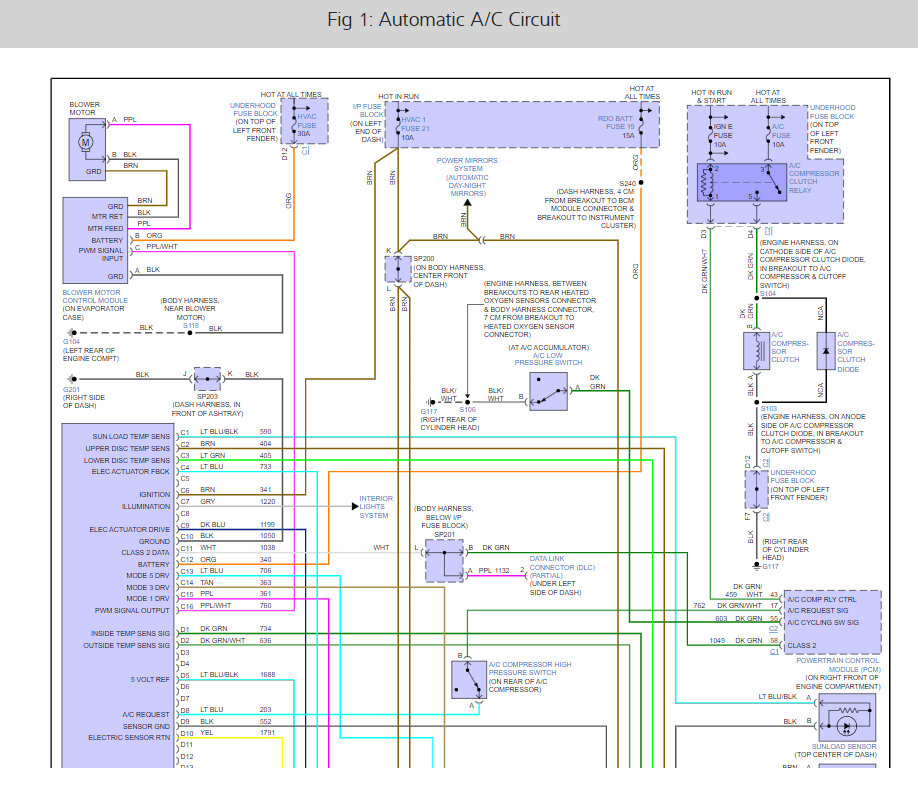

FINK4683
  • 21 POSTS
I can get the blower to run by splicing the purple wire on relay harness from positive on battery buy fan will not run without it. Replaced the resistor and nothing. Any recommendations?
Sunday, January 8th, 2023 AT 2:24 PM
KEN L
  • MASTER CERTIFIED MECHANIC
  • 48,784 POSTS
Can you check the HVAC fuse in the under-hood fuse panel for power?
Here is a guide to help and the blower motor wiring diagrams so you can see how the system works:
+1
Sunday, January 8th, 2023 AT 5:56 PM
