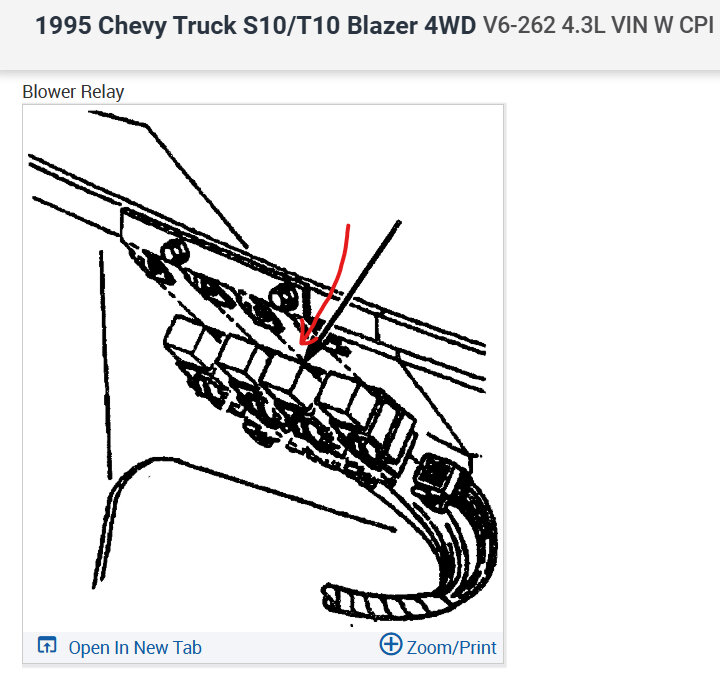

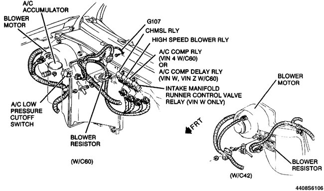

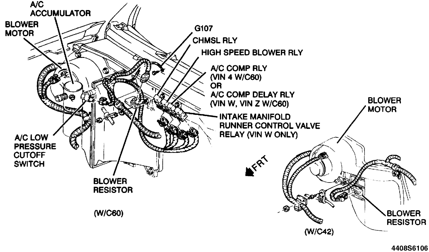

Check the blower motor relay right rear of engine compartment and also the blower motor resistor same location
Dec 16, 2007 at 2:36 PM
  • 55,561 POSTS
If the blower stopped working completely chances are the blower motor itself is bad, I would also swap out the high speed relay which sounds like it has gone out. Here is a guide to help you test and I have included how to change the blower motor out and the locations of the high speed fan relay as well.
https://www.2carpros.com/articles/how-to-test-an-automotive-hvac-system-blower-fan-motor-a-detailed
Check out the images (below). Let us know how it goes
